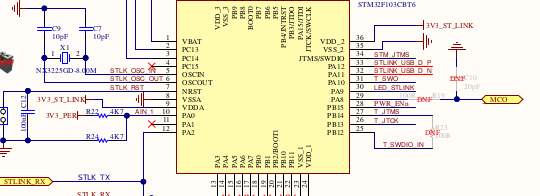

Are you sure it uses a 25 MHz XTAL? Should use 8 MHz from ST-LINK or 32.768 KHz from LSE XTAL
Check HSE_VALUE define, and if you're using the MSI or HSI clock sources.
Availability and quality of baud rates will depend on available source clock.

Hello
STM32L412 NUCLEO uses 8 MHZ Clock from STLink as HSE
STM32L432KC NUCLEO uses 25 MHZ XTAL osc

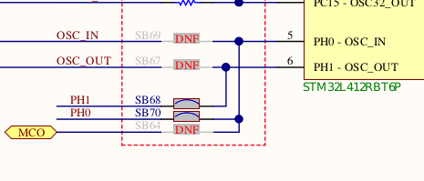

Hello @Vangelis Fortounas​ ,
I think I don't understand at all your reply.
Nucleo64 jumper SB64 is open by default
The schematic correctly represents the real hardware connection.
HSI clock @16 MHz can be used with the PLL and getting a wide range of sys clock frequencies, smaller or greater than 25 MHz.
Using LL drivers, once set up the oscillator, the baudrate divider is automatically calculated into the function
LL_USART_SetBaudRate
called from
LL_USART_Init
What should be the difference from one clock frequency to another if both can achieve a correct divider for baudrate = 115200 ?
Thanks.
s.
MSI clock seems to work fine.
Thanks fot the hint.
s.
Hello, I was completely wrong about clocks. ( checked wrong schematics)
Hello .About the clocks , i was wrong(checked wrong schematics).
The difference is in the the Freq drift over the whole temperature range.
The most accurate clock source has the less probability to produce Frame Errors
