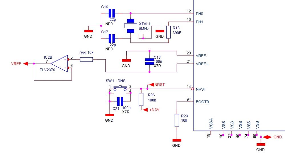

    I added a picture of the ADC circuit, as you can see an opamp is already in place.0690X00000604GCQAY.jpg

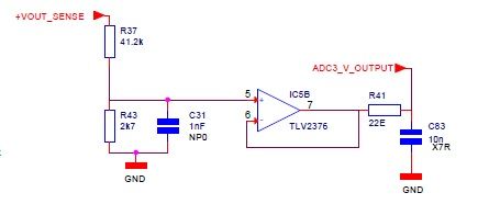

    OK I measured with a multimeter (calibrated Fluke 187 0.1mV resolution) over C83 (to VSSA). VREF I set to 2.5V. Here is what I observe:
    V_C83 < 1.250V: ADC results increase smoothly according to the applied voltage
    1.250V < V_C83 < 1.254V: ADC returns always 2047
    1.254V < V_C83 < 1.267V: ADC results fluctuate between 2047 and correct value
    V_C83 > 1.267V: ADC results increase smoothly according to applied voltage
    I tend to conclude this is a issue caused by internal ADC of the STM32L4.
    Can anyone from the ST team maybe comment on my observations?

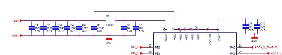

    Posted on January 24, 2018 at 10:11
    decoupling of VDDA:
    waclawek.jan
    January 24, 2018
    Posted on January 24, 2018 at 20:33
    Looks good.
