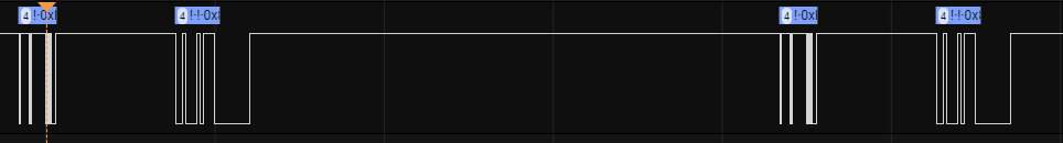

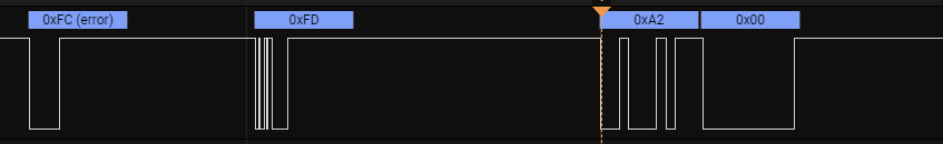

> Show it.
I attached logic analyzer screenshots. All the data are 0xA2 but with different baud rates. This is IO-Link. So first data in COM1, second COM2 (38400), third COM3 (4800) baud.

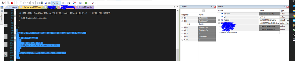

HAL_UART_Init(&huart2);And here is the UART RX callback
void HAL_UART_RxCpltCallback(UART_HandleTypeDef *huart)
if(ch == 0xA2)
__breakpoint(0);
BSP_ReceiveCallback(ch, 0x00);
HAL_UART_Receive_IT(&huart2, &ch, 1);

Why are you changing the baud rate mid stream here? The logic analyzer says there are issues, but that's because you're changing the baud rate.
You should be able to send a known signal at a known baud rate and view that in the logic analyzer to determine if the clock speed is as you expect. That would be step 1 in analyzing the problem. It looks like you're also sending 0x00 in addition to 0xA2.
