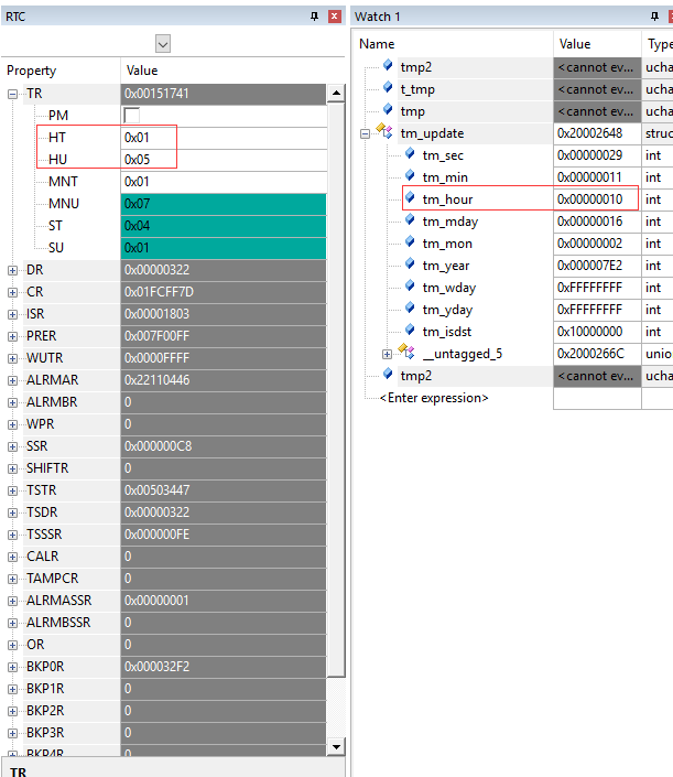

   I'm using a board with one stm32l071.I have get code by stm32cubemx,and then I added my code on that.
But now I have a issue with RTC,after I set the RTC registers, the hour in the register is less than my setting.For eg, I set 15:30:00 to the RTC registers, but I will get 14:30:00 after my setting code.
This will occur when I debug in keil simulation using full speed running,but when I debug step by step,this will not occur!
Thanks for your help if you know how to solve the problem.

log:
2018-3-22   16:30:18
set date..<0>(0-OK,1-ERR,2-BUSY,3-TIMEOUT)
set time..<0>(0-OK,1-ERR,2-BUSY,3-TIMEOUT)
2018-3-22   15:30:18
AT update time suc!
2018-3-22   15:30:18
2018-3-22   15:30:19
2018-3-22   15:30:20
2018-3-22   15:30:21
2018-3-22   15:30:22

Posted on March 26, 2018 at 08:19
I have get the point to solve this problem. I have forgotten to set the params '
DayLightSaving
' and'
StoreOperation
' when I set the time using HAL_RTC_SetTime(&hrtc,&tmp2,RTC_FORMAT_BIN); So everything goes ok after I set these two paras when I set hours-minites-seconds.
