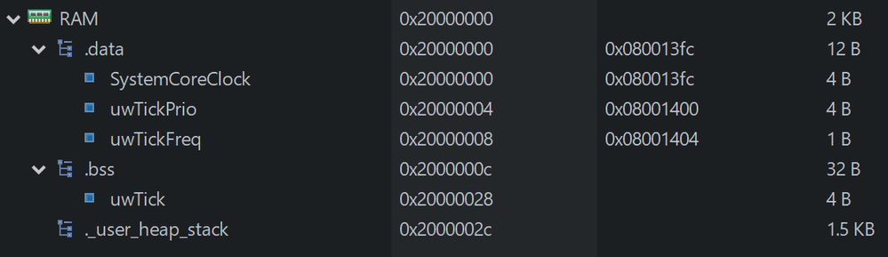

I am using STM32L011 MCU and STM32CubeIDE environment. After generating project with CubeMX and even deleting initializations in main function, 'Build analyzer' section shows that 76 % of RAM memory (of total 2KB) is used. What might consume so much memory?

You can look in the map file to find out what's in use. CubeMX isn't really built for chips with a super-low RAM amount.
You can build in Release mode to mitigate.
Actually, I was interested. Turns out 512 bytes is the default stack and 1024 bytes is the default heap.
You can adjust these in the linker script.
_Min_Heap_Size = 0x200;	/* required amount of heap  */
_Min_Stack_Size = 0x400;	/* required amount of stack */
HAL only uses 48 bytes of RAM, way less than I expected.
