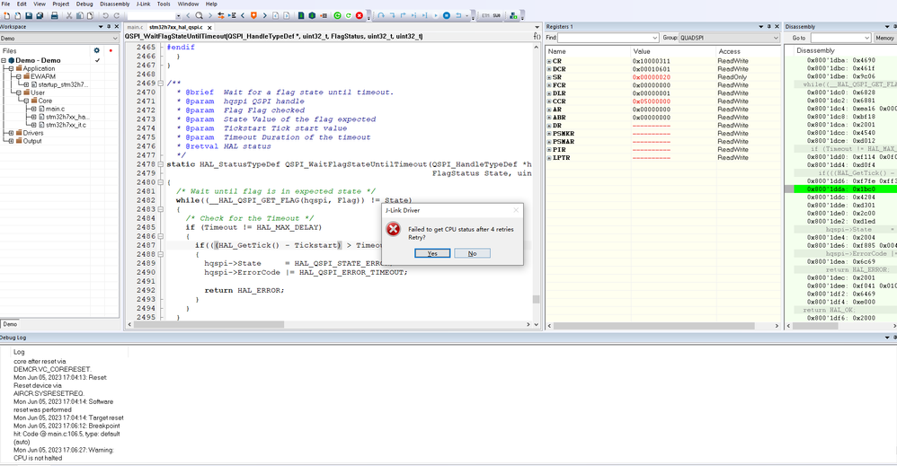

if the DummyCycles = 0,the program is running abnormally.
if the DummyCycles over 2,the program is normally.

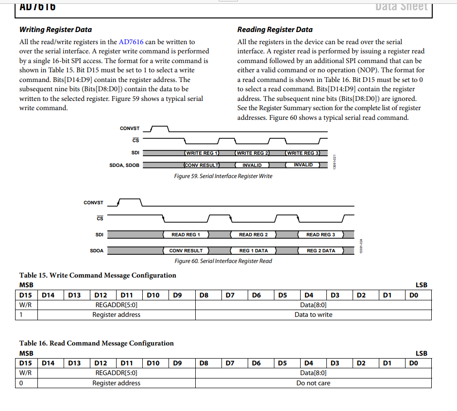

My application uses qspi to communicate with the AD7616 chip,read registers without the need for a dummy cycle。If I increase the dummy cycle, the received data will be abnormal。
​When the dummy cycle set 0, the application freezes and needs to be powered off and restarted to emulate。

It is mentioned in the errata sheet ES03932, for the STM32H743 MCU , when the QUADSPI is configured in Indirect read with only the data phase activated (in Single, Dual, Quad or Dual-quad I/O mode), the QUADSPI peripheral hangs and the BUSY flag remains of the QUADSPI_SR register remains high. An abort must be performed to reset the BUSY flag and exit from the hanging state.
Workaround: Insert a dummy phase with at least two dummy cycles.
