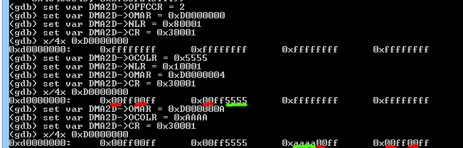

Posted on September 23, 2017 at 11:42
So, I did some more detailed investigation of what is going on with DMA2D. Here is a first gdb console screenshoot:
You can see I programmed DMA2D to fill the 8 words (16bit pixels) starting from the 0xD0000000 address with 0xFFFF. This operation was successful cause address and line size were 8byte aligned.
Then I programmed DMA2D to emit one pixel at 0xD0000004 address with 0x5555 ''color''. You saw what I got (the green underline indicates right and expected result, the red underline is the problem) - the unusual thing is that
bytes
was changed (not
words
as I thought before). Then I repeated one pixel operation for the 0xD000000A address and got the same result. I have no mind what is going on (chip problems?)...

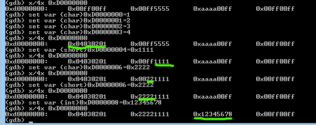

The next screen shoot demonstrates direct data write to the SDRAM (not using DMA2D), as you can see everything works finely. Of cause it is not the real memory test, but I run tests also and they indicated no problems:
I would like to hear any thoughts, please!

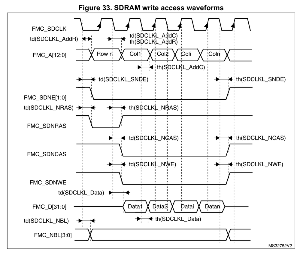

Posted on September 23, 2017 at 12:04
Figure 33 from the stm32h743 datasheet gives an explanation why such address bus connection should work:
As you can see FMC issues column address for each word being write to the SDRAM (the same is true for the read as can be seen on the Figure 32). Of cause I expect the datasheet is correct.
