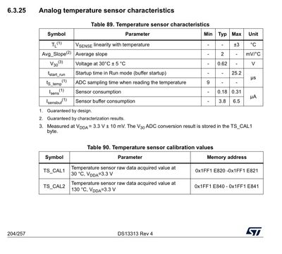

Heyho,
got my custom board running, only (minor) problem until now:
internal analog temperature sensor (ADC3) value seems to be off, showing something like ~60°C,
while an external sensor shows about 30°C.
"Finger test" confirms rather the 30°C.
I have the exactly same code running on H723 Nucleo and H735 Disco, the values I get from these make sense.
ADC3 is working, I'm measuring about 7 supply voltages on the board and the internal Vref, all these values are close to perfect.
The only difference:
VREFP pin is connected to an external voltage reference with 3.0 V, VDDA is 3.3 V, compared to the Vref 3.3V on the ST boards.
So how does this affect the temperature sensor?
Even with a factor of (3.3 / 3.0) the measured temperature is still far off.
Here's how temperature is calculated, input is an averaged float from ADC buffer (I checked that this value is close to a single raw ADC value):
/* convert averaged float ADC value to temperature */
float ConvAdc2Temp(float flAdcTemp)
	/* calculate temperature, see reference manual */
	float flTempVal = flAdcTemp;
	flTempVal -= (float)((int32_t)*TEMPSENSOR_CAL1_ADDR);
	flTempVal *= (float)TEMPI_CAL_MULT;
	flTempVal += (float)((int32_t)TEMPSENSOR_CAL1_TEMP);
	return flTempVal;
Here's the output, including the MCU's internal calibration values, which are very close to those on the ST boards:
MCU internal temperature sensor:
ADC3 TmpSns: 866 / 0x0362
flTempMCU: 62.2 °C
TEMPSENSOR_CAL1_TEMP = 30
TEMPSENSOR_CAL2_TEMP = 110
*TEMPSENSOR_CAL1_ADDR = 768
*TEMPSENSOR_CAL2_ADDR = 1022
TEMPI_CAL_MULT = 0.31496
TMP101 external temperature sensor:
flTempSns: 34.0000 °C

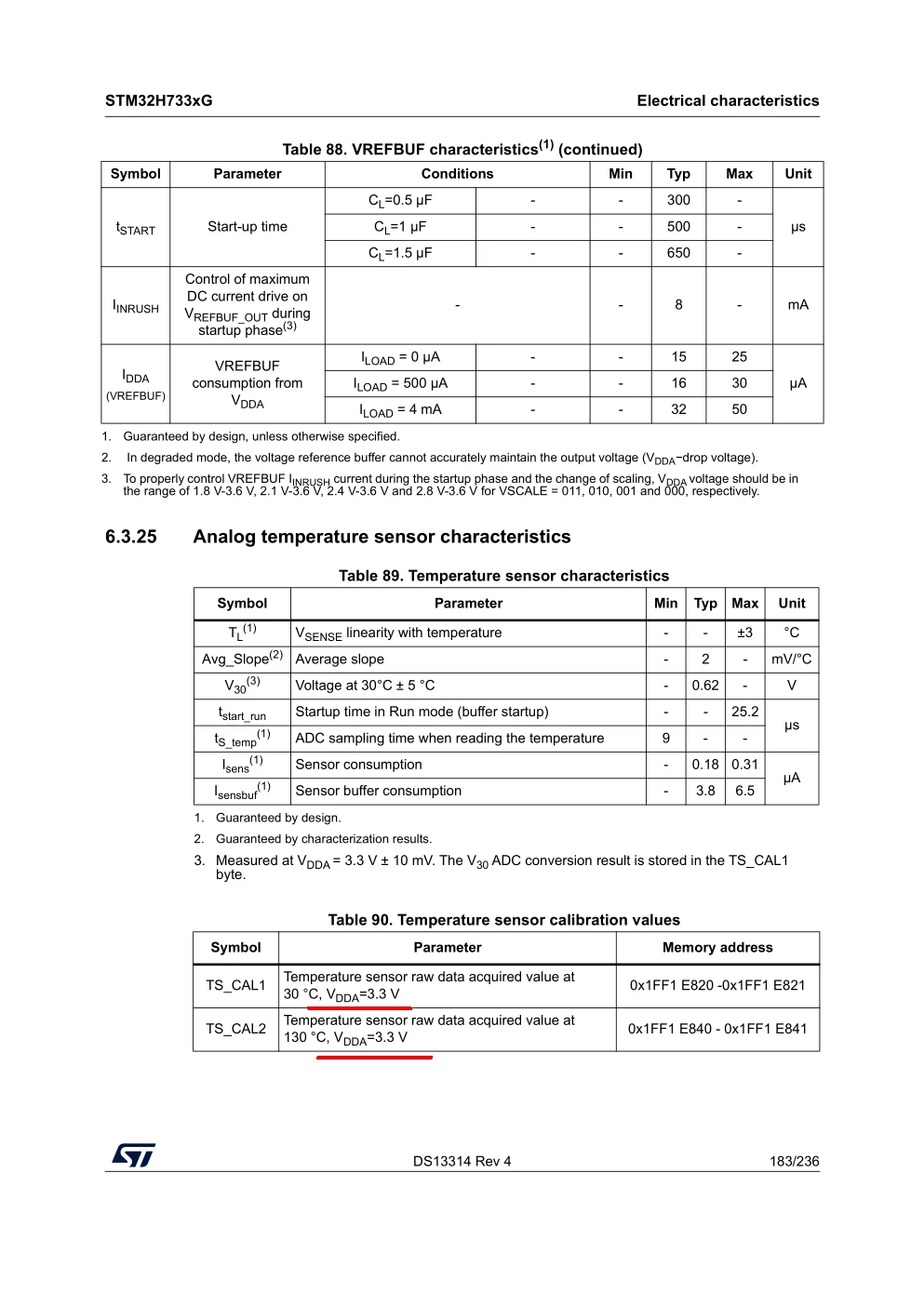

Best answer by waclawek.jan
> How does the external reference voltage of 3.0 V affect the temperature sensor?
In the same way as for any other ADC measurement. What you want to measure is the temperature sensor's voltage; for that you take ADC reading and then convert it into voltage by using the reference voltage.
Also, if you want to use the constants stored in system memory, for 'H733 they have been taken for VREF=3.3V (the DS partially incorrectly says VDDA=3.3V), so you have to take that into consideration when using them in calculation, too.

There's still the open question:
I can't find anything in the datasheet or RM, although it makes sense that the result has to be multiplied by 3.0/3.3.
But maybe there are other effects, like the TS cal values stored in flash don't make sense anymore?
waclawek.jan
waclawek.janBest answer
June 27, 2024

@waclawek.jan 's document showed me the solution:
yes, it is a simple correction factor 3.0 (used Vref) / 3.3 (Vref at factory calibration), but it has to be applied to the raw ADC output from the temperature sensor.
BIG THANKS again to Jan!
PS: a few non-ST guys here should be paid by ST!
STOne-32
June 27, 2024
Dear @LCE  @waclawek.jan ,
Thank you very much for the spotting that issue and formula in our reference manual which is only valid for VDDA=VREF+=3,3Volts , another case is here and will be fixed On chip temperature sensing dependant on Vref - STMicroelectronics Community
Thanks again
