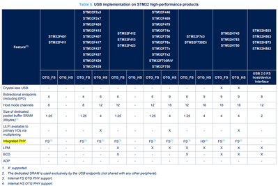

is there a way to search for which stm32h7 mcus have integrated HS usb phy?
the mcu finder product selector doesn't have such filter, is there an app note, a product brief or anything like that?

Hi @yakabmarci ,
The information can be found in AN4879Introduction to USB hardware and PCB guidelines using STM32 MCUs and precisely table 5:

AScha.3
afaik the only chip with HS USB by stm is F723 . thats why mcu-finder shows no H7 cpus...  :)
+ thats why it is used in the st-link V3 .
if you need hs usb on chip maybe look at cpus by NXP, Nuvoton...

Hi @yakabmarci ,
Regarding your proposal for the product selector: I'll raise it internally.

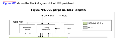

seems there is an error in the table: H563 has FS phy internal. - but not in this table.
from rm :

I would love it if the STM32 product selector had the ability to filter for integrated USB HS PHY as well. Currently it is really annoying to find STM32 MCUs that have an integrated USB HS PHY. And I really do not wanna deal with external USB HS PHYs, so finding MCUs that have an internal one is really important.
USB HS PHY  have afaik :
- STM32F722/723/730/732/733
- STM32U5Axxx
- STM32U59xxx
But look in table with different cases - to be sure. (not all F7xx have hi speed PHY )
