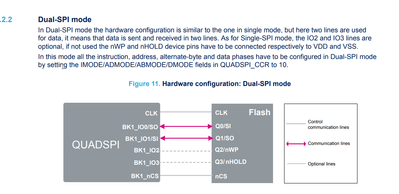

My only need is to use QSPI (dual mode bank1) as a simple/normal SPI to drive external DAC (AD5066).  I should only use the Data phase, I don't need the Instruction, Address, Alt and Dummy phases of the QSPI.
I have to use:
QUADSPI_CLK---> DAC_CLK
QUADSPI_BK1_NCS---> DAC__CS
QUADSPI_BK1_I00/SO(MOSI)---> DAC_MISO
QUADSPI_BK1_I01/SI (MISO)---> DAC_MOSI ( no need for DAC because is only slave)
I would like to use only the Data phase of the QSPI to send the 4 Bytes for the ADC (command, channel, data bits ...)
It is possible to use the QSPI as a SPI normal with a ADC and not with a flash memory?
I've tried using the example QSPI/QSPI_ReadWrite_IT but I can't see anything coming out to the CLK and SI (MOSI). There are other examples not for memory?

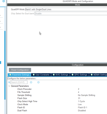

In main the two functions HAL_QSPI_Command(....) are working, I see clock and output data with oscilloscope, the
HAL_QSPI_Trasmit_IT (...) is made but I don't see the data and clock in output. My goal is to use only the HAL_QSPI_Trasmit_IT (...) for send 4byte to external DAC.
static void MX_QUADSPI_Init(void)
{/* QUADSPI parameter configuration*/
hqspi.Instance = QUADSPI;
hqspi.Init.ClockPrescaler = 2;
hqspi.Init.FifoThreshold = 4;
hqspi.Init.SampleShifting = QSPI_SAMPLE_SHIFTING_NONE;
hqspi.Init.FlashSize = 31;
hqspi.Init.ChipSelectHighTime = QSPI_CS_HIGH_TIME_1_CYCLE;
hqspi.Init.ClockMode = QSPI_CLOCK_MODE_0;
hqspi.Init.FlashID = QSPI_FLASH_ID_1;
hqspi.Init.DualFlash = QSPI_DUALFLASH_DISABLE;
if (HAL_QSPI_Init(&hqspi) != HAL_OK)
Error_Handler();

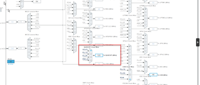

void SystemClock_Config(void)
HAL_PWREx_ConfigSupply(PWR_LDO_SUPPLY);
__HAL_PWR_VOLTAGESCALING_CONFIG(PWR_REGULATOR_VOLTAGE_SCALE1);
while(!__HAL_PWR_GET_FLAG(PWR_FLAG_VOSRDY)) {}
__HAL_RCC_SYSCFG_CLK_ENABLE();
__HAL_PWR_VOLTAGESCALING_CONFIG(PWR_REGULATOR_VOLTAGE_SCALE0);
RCC_OscInitStruct.OscillatorType = RCC_OSCILLATORTYPE_HSI48|RCC_OSCILLATORTYPE_CSI;
RCC_OscInitStruct.HSI48State = RCC_HSI48_ON;
RCC_OscInitStruct.CSIState = RCC_CSI_ON;
RCC_OscInitStruct.CSICalibrationValue = RCC_CSICALIBRATION_DEFAULT;
RCC_OscInitStruct.PLL.PLLSource = RCC_PLLSOURCE_CSI;
RCC_OscInitStruct.PLL.PLLM = 1;
RCC_OscInitStruct.PLL.PLLN = 240;
RCC_OscInitStruct.PLL.PLLP = 4;
RCC_OscInitStruct.PLL.PLLQ = 6;
RCC_OscInitStruct.PLL.PLLR = 2;
RCC_OscInitStruct.PLL.PLLRGE = RCC_PLL1VCIRANGE_2;
RCC_OscInitStruct.PLL.PLLVCOSEL = RCC_PLL1VCOWIDE;
RCC_OscInitStruct.PLL.PLLFRACN = 0;

On a hardware level, it seems possible:
