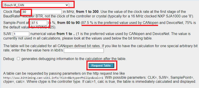

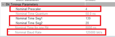

Looking at your ioc file, I don't see issues with neither your clock source of FDCAN nor the FDCAN bitrate config. Meanwhile, I prefer to be sure there is no issue with the sampling of the CAN bit:
I used this site http://www.bittiming.can-wiki.info/ to fit your needs as you're using CANopen:
Bitrate is 125kb/s and the sample point is selected to be at 87.5 % as indicated.SofLit_0-1718373419189.png
So the prescaler = 4, SEG1 = 139 and SEG2 = 20.
I prefer to select the lowest prescaler value with highest SEG1/SEG2 values (for a best bit sampling resolution) fitting a given sample point:

But from my point of view, the prescaler/timing settings shall not effect my problems:
I assume, that the CAN Hardware interface will receive a valid CANopen message and validate each message by unique CRC of each CAN message. If it's not valid -> message will be thrown away. If it's valid -> message will be put into FiFo which will be available inside CAN Callback function.
So normally I would be able to receive only valid can messages.
Actually I have CAN1 and CAN2 Interface both on Fifo0 - but I only have traffic on CAN1 - will this be an issue?
Any further suggestions?
