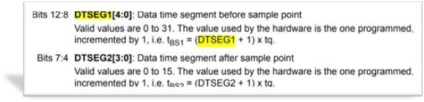

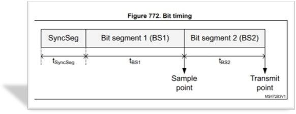

Documentation, RM0468, latest edition:
61.4.4 Bit timing, pg. 2528
Synchronization segment (SYNC_SEG): a bit change is expected to occur within this
time segment, that has a fixed length of one time quantum (1 x tq).
DBTP reg description, page 2567:
Therefore the length of the bit time is (DTSEG1 + DTSEG2 + 3) tq for programmed values
Same descr. in NBTP.
So, which one is correct, or are these 2 different things?
@Imen DAHMEN​ please?
Edit: Same in G4 RM

Anyway, note the documentation bug in DBTP and NBTP registers.
I'm pretty sure now that the +1 for the bit time is the correct value (instead of the +3).

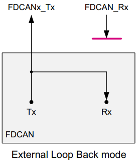

LCE
LCEAuthor
Principal II
February 28, 2023
This is almost funny...
When I set FDCAN1 Mode to FDCAN_MODE_EXTERNAL_LOOPBACK, it sends with 8 Mbps, and FDCAN2 receives data correctly.
When I set FDCAN2 back to FDCAN_MODE_NORMAL, no 8 Mbps on the scope, no Rx on FDCAN2.

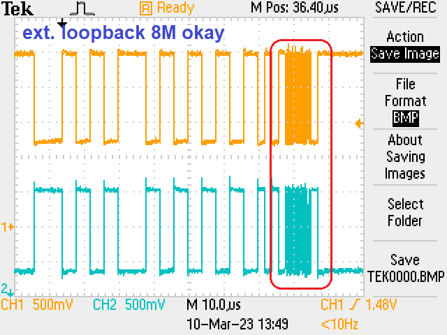

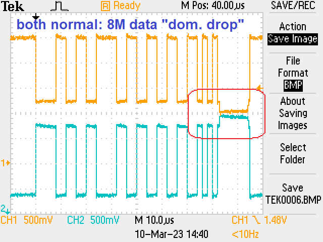

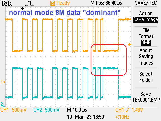

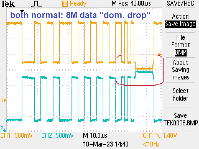

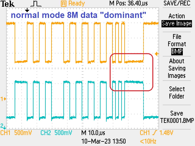

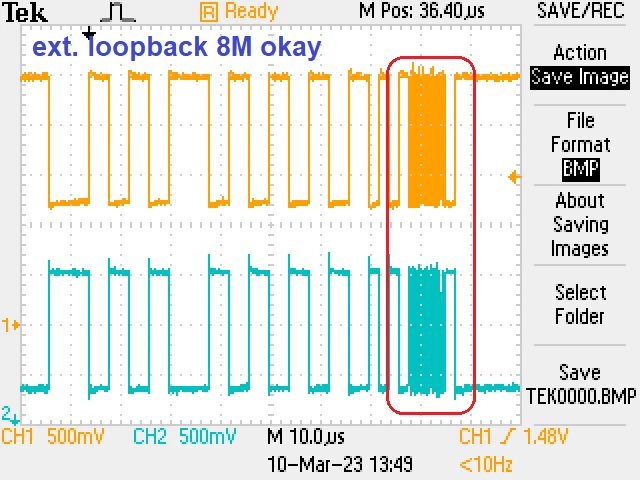

So here are some screenshots from my (ancient) scope.
Pic 1: one of the 2 FDCANs (doesn't matter which) is in external loop mode, this one can transmit 8M data, the other FDCAN receives data correctly
Pic 2: FDCAN in normal mode - but "alone on the bus", instead of 8M data there's only "dominant" level = 0V (for the yellow "+" side); FDF, res and BRS bits are okay.
Pic 3: both FDCANs in normal mode, instead of 8M data there's only "dominant" level = 0V (for the yellow "+" side); FDF, res and BRS bits are okay.
Here the "dominant" level at data time drops even lower, as if both FDCANs pull it down.

... and here are the PSR & ECR registers:
after sending a message with one of the FDCANs in external loop mode:
  • both FDCANs indicate they have received a message with bit rate switching: PRS = 0x0000300F; bits REDL and RBRS are set
  • ECR = 0 -> no errors
That's how it should be, I'd say.
after sending a message with both of the FDCANs in normal mode - all other settings exactly the same:
sender:
  • PSR = 0x0000050F
    • DLEC (data last error code) = 5 -> error: bit 0
  • ECR = 0x00010008
    • 8 TX errors
receiver:
  • PSR = 0x0000020F
    • DLEC = 2 -> error: format
  • ECR = 0x00010100
    • 1 RX error

But unfortunately, even with the timings from your tool, the problem is still the same.
