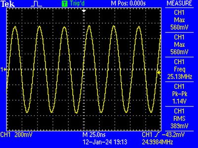

This is the non functional board's Main crystal clock out. it seems the clock is working but the controller not taking the clock, something wrong with the controller

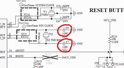

Hi @mƎALLEm,
Our revision is X, and we found a problem that is neither related to the MCU nor the main crystal (HSE). It is associated with the RTC crystal (LSE). When we remove the load capacitors of the RTC Clock, it works every time. Thank you for your support, ST; your assistance means a lot to me.

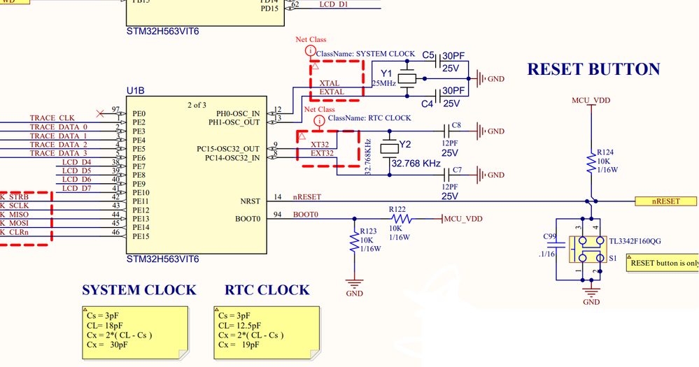

can you share the schematics around the 25MHz crystal ? , PCB and also crystal datasheet to try to help .
Cheers,
STOne-32

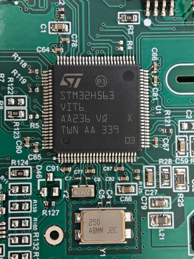

Here is the schematic and PCB image of the board. We are using a 25MHz crystal with the part number ABMM-25.000MHZ-D-2-X-T, and the load capacitor we have used is 30PF, 25V C0G/NP0 5% (0201)
Please find the datasheet of crystal from here: ABMM1 (mouser.com)
or below I've attached the same.

30 pf load capacitor is way too big!
Try 12 pf or 8 pf and test again.

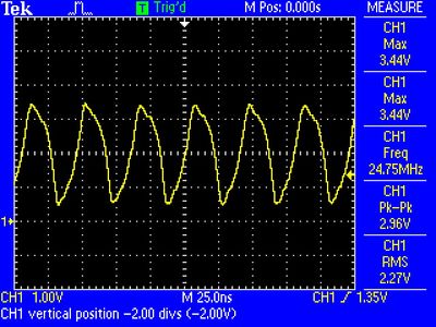

The 25MHz is already on the output. Are you probing on one of the MCO pins?
Here I'm providing 2 .ioc file one is with HSI clock configuration, and one is with HSE clock configuration.
Here the non-working board is not working with test_led_HSE_Clock_configuration.ioc
and I didn't probe on the MCO Pins, I'll try that, and I'll let you know.

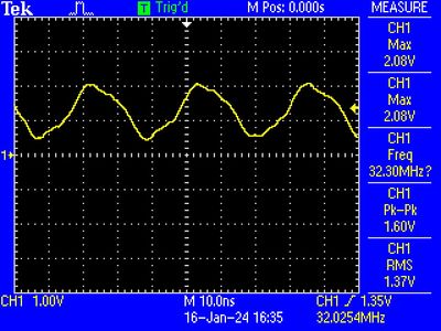

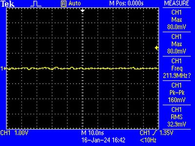

Non-working board: HSI signal out from MCO pinNon-working board: HSI signal out from MCO pin
Non-working board: HSE signal out from MCO pinNon-working board: HSE signal out from MCO pin
For your reference The HSE out of a working board.
working board: HSE signal out from MCO pinworking board: HSE signal out from MCO pin

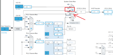

Thank you for the sharing. But according to your test_led_HSE_Clock_config.ioc file, the system clock source is set to CSI not HSE:
Could you please double check?
Yeah, I've changed that and tested it on the non-working board but still it's not working as expected.

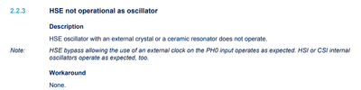

Its seems it's related to this errata:
Please refer to the errata document on this link.
But the limitation is available only on Rev A.
What is the revision of the failing devices?
