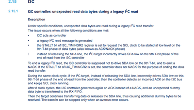

I want ust I3C private Read as target but send only 8byte and this error to Error Handler.

Hello @ElectronicABC
Please check if you have the condition described in the STM32H563xx Errata sheet which is related to I3C controller: unexpected read data bytes during a legacy I2C read.
Thanks
Imen

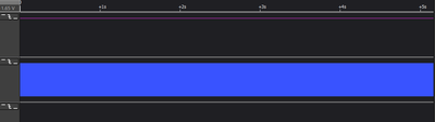

some times the Controller  SCL all clock  forever and not to stop.
