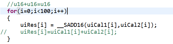

I want to test the execution speed of SIMD instruction. My demo as below.
16-bit addition, for example.
0693W00000HnjelQAB.pngI find the instruction __SADD16() in cmsis_gcc.h. The execution time using __SADD16 is 27us and the time without __SADD16 is 23us.  It seems like that the speed is more slow when using __SADD16.
Am I calling the wrong function? Please tell me how to use SIMD instruction correctly to speed up addition or multiplication.
Thanks

SADD16 is a dual 16-bit signed addition. So you pass it two int16_t values packed in the form of a uint32_t and it calculates the result in a single instruction.
It looks like you're only performing one addition at a time, so the two are things you're profiling are not equivalent. Would have been nice to see how uiCal1 and uiCal2 are defined.
Your comments also say u16 but SADD is for signed addition, not unsigned.
Examining the disassembly would also be enlightening. You're running more than a simple SADD16 instruction in each loop.

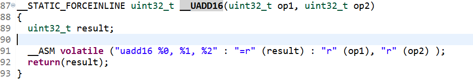

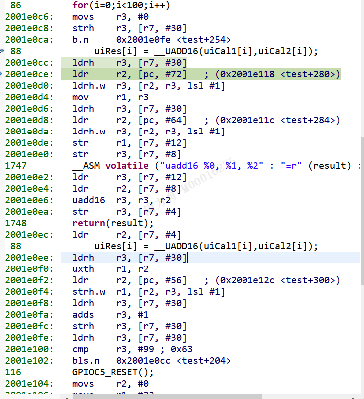

0693W00000HnjwBQAR.pngfigure 1
0693W00000HnjwLQAR.pngfigure 2

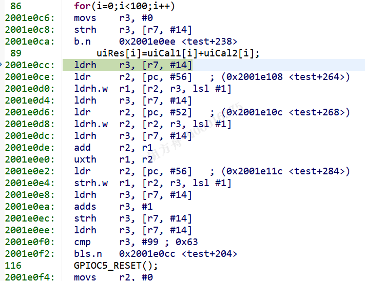

The figure2 is the body of __UADD16(), and the figure1 is the corresponding disassembly

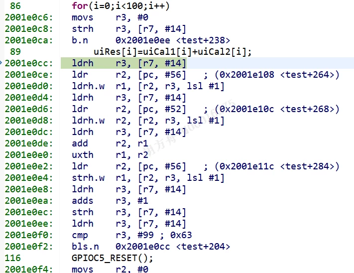

0693W00000HnjwpQAB.pngfigure 3
The figure3 is the disassembly of uiRes[i]=uiCal1[i]+uiCal2[i];
It can be seen that the figure 1 has more disassembly instructions than figure 3.
