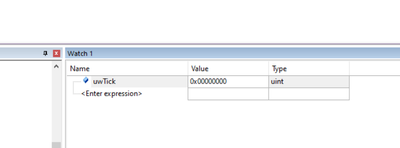

STM32G4 using HAL Lib to read eeprom, when wirte to eeprom many times, the SYSTICK's tick variable will be changed randomly

hi,
for our project,we used firmware package was STM32CubeG4 Firmware Package V1.6.0 / 05-June-2024.
IDE: MDK 5.39
MCU: STM32G473MET6 EEPROM: 24LC256
we already check the page write opreation, ensure the boundaries and size of each write (less than or equal to the page size)
we have also tried DMA and IT, but they will affect SYSTICK
this our test code

The systick code is dirt simple. You can inspect it. Unlikely to be bugs there.
Why do you think it's getting changed randomly? What values do you see vs what values do you expect?

I know it's easy, that's why I'm confused. The variable 'uwTick' operated by the default code generated by CubeMX mentioned above, when I perform multiple eeprom writes, the value will randomly jump, but after writing, it will count normally.
The "uwTick" variable in the watch window will randomly change, such as suddenly resetting to zero, or suddenly becoming 0x20xxxxxx, or 0x80xxxxxx. However, after the write operation is completed, the variable will count normally based on the changed value
Yeah that's a weird one.
If uwTick is getting modified, you can set up a conditional breakpoint and see what instruction is causing the bad behavior. Possibly an out of bounds write.
It could also be an IDE issue, maybe reading from the wrong address. Seems less likely. Consider sending uwTick out via UART or similar to eliminate that possibility.

Really shouldn't jump around unless you're trashing the environment.
With Keil make sure you've allocated an adequate STACK (see startup_stm32xyz.s) otherwise in will plough into the HEAP and STATICS/LOCALEs
Watch your local/auto variable allocations and call-depth
Thank you very much. The problem has been solved because the stack is too small
mas666
Thanks. The problem has been solved
