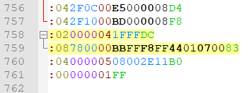

I made it. My workaround is that I now set the optionbytes directly at the end of the hex file.
Only the two marked lines need to be inserted.
