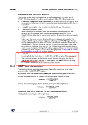

I wanted the meaning of "he second half of the stop bit" clarified.
In the case of a 2stop bit setting,
① Is it the latter half bit of the first stop bit?
② Is it the latter half bit of the second stop bit?
③ Or is the glitch in the latter half bit NG regardless of which stop bit it is?
Which of ① to ③ is correct?

waclawek.jan
> the number of bits in the communications protocol must be matched on the sender and receiver sides for communication to be established
No.
This basically says, that the 2nd stop bit is entirely ignored in the receiver.
Hello waclawek.jan
Thank you for providing the excerpt from the reference manual.
I could understand that in 2 stop bit mode, if there is no error in the first BIT, then readable normal data is written to the FIFO at that point.
So, even if there is a glitch in the second BIT, it is impossible for corrupted data to be written to the data register.
You're a real guru. Thank you.
