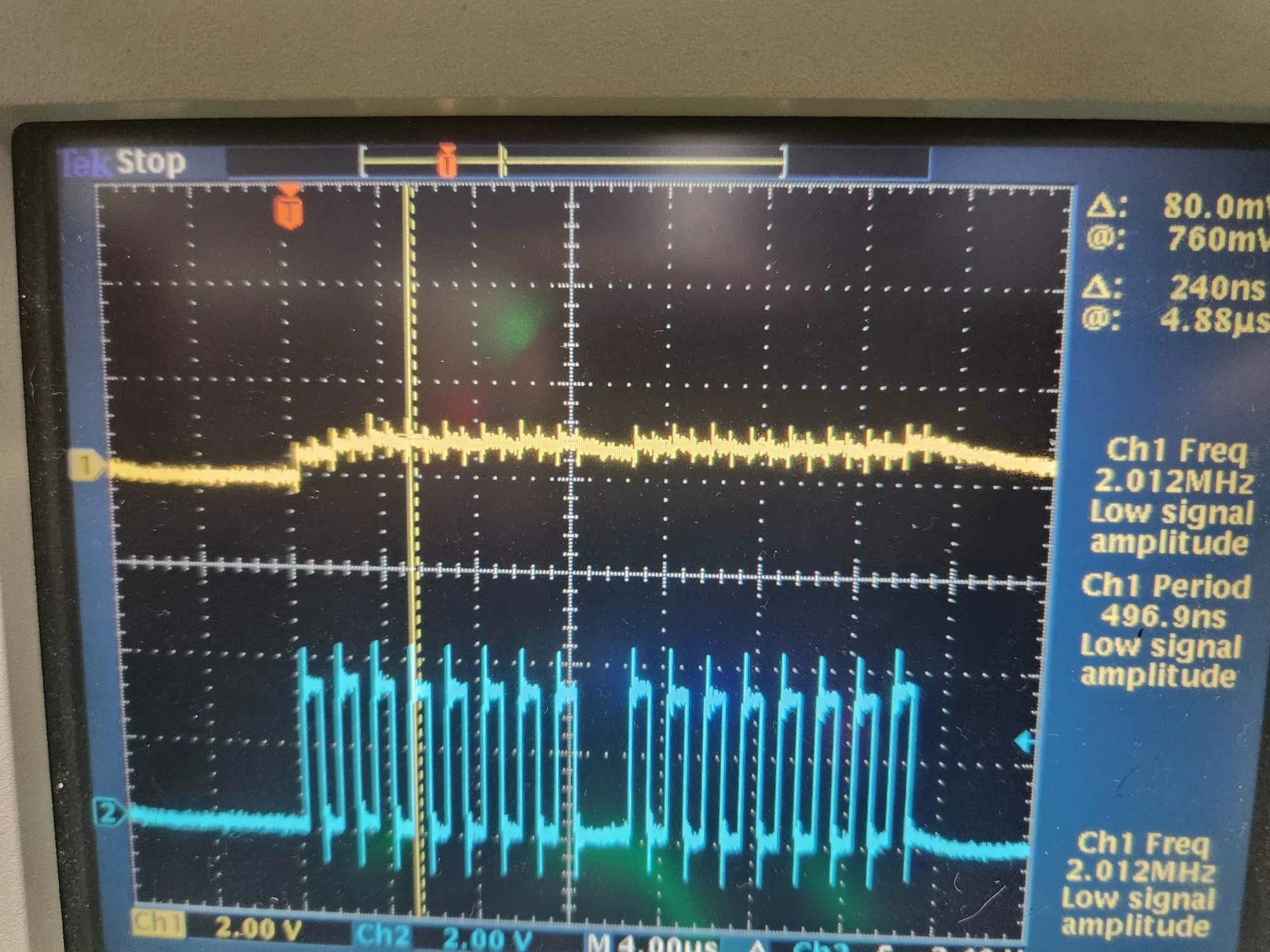

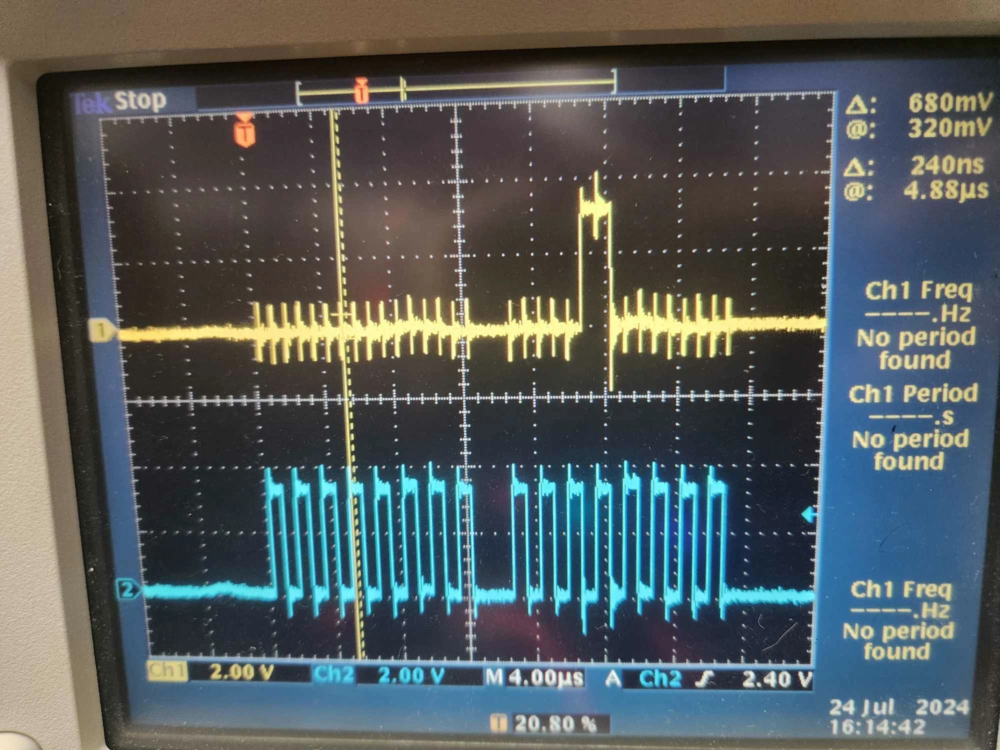

I'm trying to set my setup my SPI1 as slave full duplex on my STM32G030K8 and i reach the HAL_SPI_TxRxCpltCallback when receiving message, but I always read value 0 in my rxbuffer when my master is spamming 16 @ 1MHz at a 1 sec intervall. Also, my slave should be answering 196 base on the value place in the txbuff, but nothing seem to get out;

Blue: SCK Yellow: Mosi
Yellow: MISO     Blue:SCK
Thank you!

    Incorrect MISO/MOSI setup in GPIO?
    Read out and check/post content of relevant GPIO registers.

    Sorry for the delay it seem like it  was a hardware problem, i change the chip and now it work
