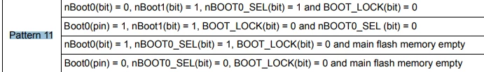

I found that for my MCU, I need Pattern 11 to activate bootloader, which means:
But after searching whole datasheet of the mcu, only boot bit setting I found was PA14-BOOT0 and there is no other boot bits to set up in cubemx.

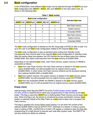

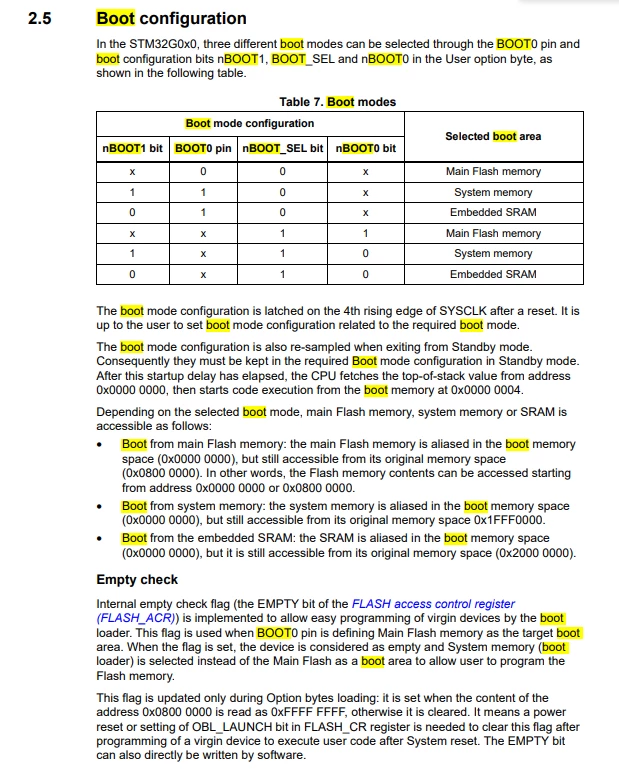

You can find details about boot pin and boot bits on the part 2.5 of the RM0454:

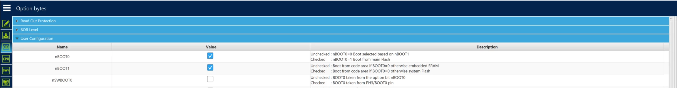

Those boot pins can be configured throw CubeProgrammer (under option bytes->User Configuration):

2024-08-29 12:35 AM
Hello @KlemenDS and welcome to the ST Community :smiling_face_with_smiling_eyes:.

Thank you very much for accurate and fast answer.

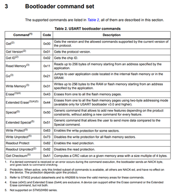

I know that the main application code on flash memory is not loaded at start up (mcu not responding to uart comamdns as it does in application code), but when I try to use commands from AN3155:
I get no response on uart (trying "Get version" and "Get ID" commands). The system is connected by STM32G03 connected to FT234XD-T(chip on PCB) and then via USB to PC. The UART communication work without problem in applciation code mode, at 115200 baud.
