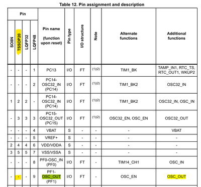

As I understand, the TSSOP20 version needs an external oscillator instead of a 8MHz crystal connected directly to the MCU pins. Is that correct?
I'm asking because I have seen a board on AliExpress using this same processor with a 8MHz crystal.
TDKBest answer
Jul 28, 2024 9:35 PM UTC
Correct, the TSSOP20 doesn't have an OSC_OUT which means it can't be hooked up to a crystal directly.
No clue what's going on with that board. Schematic doesn't seem available. Probably the crystal is not very useful on it.

Very curious. a schematic (could be typical AE misinfo) is available but shows no crystal
https://nl.aliexpress.com/item/1005005574646465.html
There's also a Baidu (Chinese Cloud drive) download link at the top of that page for a zip file of assets for that board, but it seems to be china only.
On at least one unrelated project, someone thought it was a good idea to connect a 16Mhz crystal to OSC32, I wonder if that's a clever hack or a *** mistake: hack.https://github.com/brunohoplite/stm32g030f6p6_evaluation_board/blob/master/PCB/Schematic_stm32g0f0_eval.pdf

The TSSOP20 versions of the STM32G0 only support an external HSE bypass oscillator on PC14 (OSC_IN), but they can also use a LSE crystal on PC14–PC15 as the SYSCLK source.
I would be curious to understand the purpose of this 8 MHz crystal on this STM32G030F6 board. I could not find any schematic for this board. Very strange !
