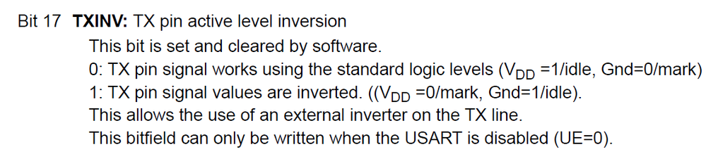

Per the title, I'm using USART2 with DMA transfer but for some reason the line stays LOW (active) before/after transmision.
Init code is pure HAL generated, I added a "DeInit" just to make sure the UART enable wasn't persisting between resets/debug sessions but it's made no difference.
No matter what I do with the control registers (UART_ADVFEATURE_TXINV / UART_ADVFEATURE_DATAINV), the data output & idle state don't seem to change.
EDIT: DATAINV and/or TXINV do seem to invert the data bits but the idle line is *always* LOW when there's no data no matter what.
Is this some edge case where using DMA transfer keeps the UART "active" all the time rather than releasing it to "idle" once transfer is complete?
EDIT #3: It appears HAL_HalfDuplex_Init means the UART behaves this way, using HAL_UART_Init seems to allow the TX line to idle high, although now the data appears to be wrong whichever way up I invert it. Ghaaa,

UART is normally idle high. You've flipped polarity with TXINV, so now the line is idle low. Are you expecting it to only invert data bits and not start/stop/idle as well?
JU_it
JU_itAuthor
Senior
March 3, 2022
Please check what I said - there is NO combination of TXINV and DATAINV that lets the TX idle high despite what the datasheet says.
This is my experience - to be clear right now I do not care which way up the data is but I need TX to idle HIGH:

Well I fixed it - half-duplex mode appears to cause the TX line to idle LOW (waiting to become RX) according to a random ST powerpoint presentation I found. Not the behaviour I expected for a configuration where we only want to TX and never RX.
Anyway, switching to TX_RX mode and most importantly calling HAL_UART_Init rather than HAL_HalfDuplex_Init seems to have fixed the problem.
Annoyingly, CubeMX will not allow you to configure UART in Asychronous mode if there's no RX pin available, so we have to put a workaround in now for TX-only case.:unamused_face:
