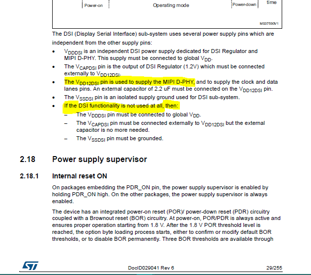

Hello, I am using stm32f769 bga package. We accidentaly connect VDD12DSI pin to VCAPSDSI pin and connect them to 3.3V VDD. We only gave power to the circuit for a few seconds. Could it damage the MCU? And if I disconnect these two pins and floating, will it work? Do I have to connect them to each other? Is there any way out?

    Hello!
    The problem is , VDD12DSI  has a maximum input voltage 1,2V . So yes, the overvoltage on this pin is possible to caused a damage to MIPI-DSI section of chip or an
    extensive damage
    or nothing!.
    The only way to see if you have damage, is to follow first the DataSheet about connection of  theese pins ,  and after to check the functionality of MCU .
    Regards
