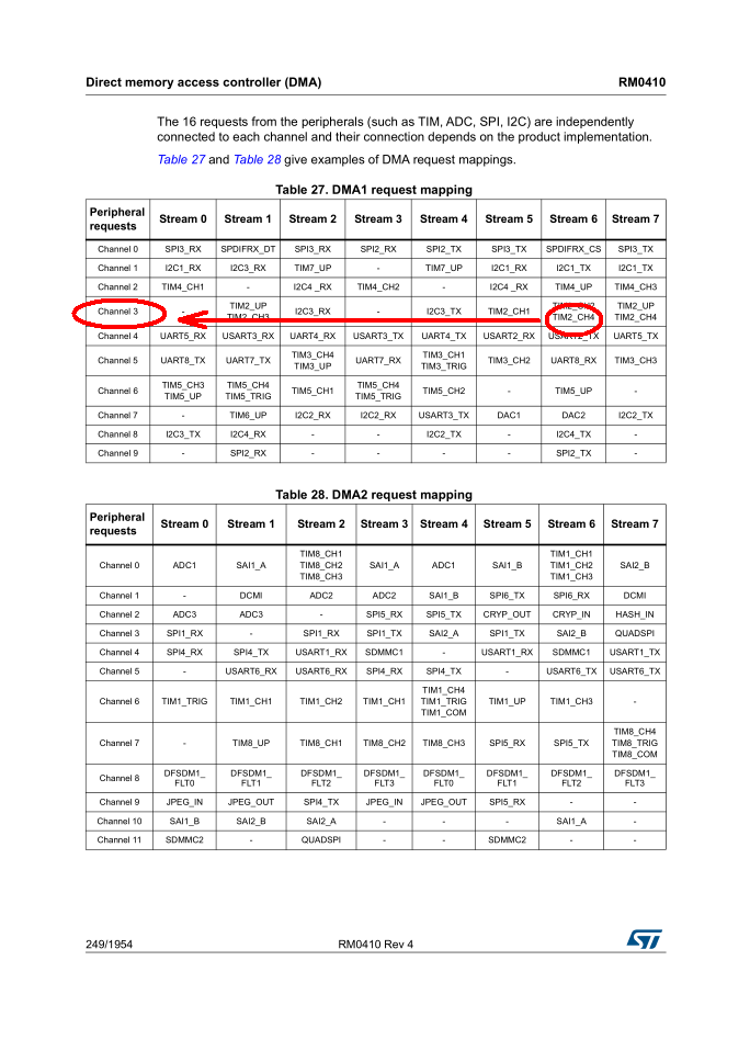

waclawek.jan
February 5, 2020
I don't speak the Cube/HAL gobbledygook, but
   /* Set the parameters to be configured */
   hdma_tim1.Init.Channel = DMA_CHANNEL_4; /* PA3 TIM2_CH4 */
is IMO incorrect, I believe you want to set the channel in given stream in DMA, corresponding to given trigger from TIM, ie.
Reading out and checking the DMA registers is always the ultimate way to find out what the mcu is actually doing.

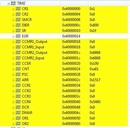

February 6, 2020
Read out and check/post the TIM and DMA registers content.
VMoca.1
VMoca.1Author
February 6, 2020

As I see in HAL_TIM_Base_MspInit() i get a warning
/* Several peripheral DMA handle pointers point to the same DMA handle.
    Be aware that there is only one stream to perform all the requested DMAs. */
I am trying to set-up two DMAs on PA2 and 3 which are both on DMA1 Channel 3 and only the stream is different (Stream1 for PA2 and Stream6 on PA3).
See code below

waclawek.jan
February 6, 2020
Okay, so this may be a Cube/HAL limitation.
Ditch Cube, go for the registers.
VMoca.1
VMoca.1Author
February 7, 2020
​Hello,
I have managed to set-up the desired PA3 to use DMA but only with Steam7.

The CubeMX is blocking selecting both CH3 TIM2_CH3 (Stream1) and CH​4 TIM2_CH3(Stream7)...
waclawek.jan
February 7, 2020
Oh, that's an unexpected twist.
