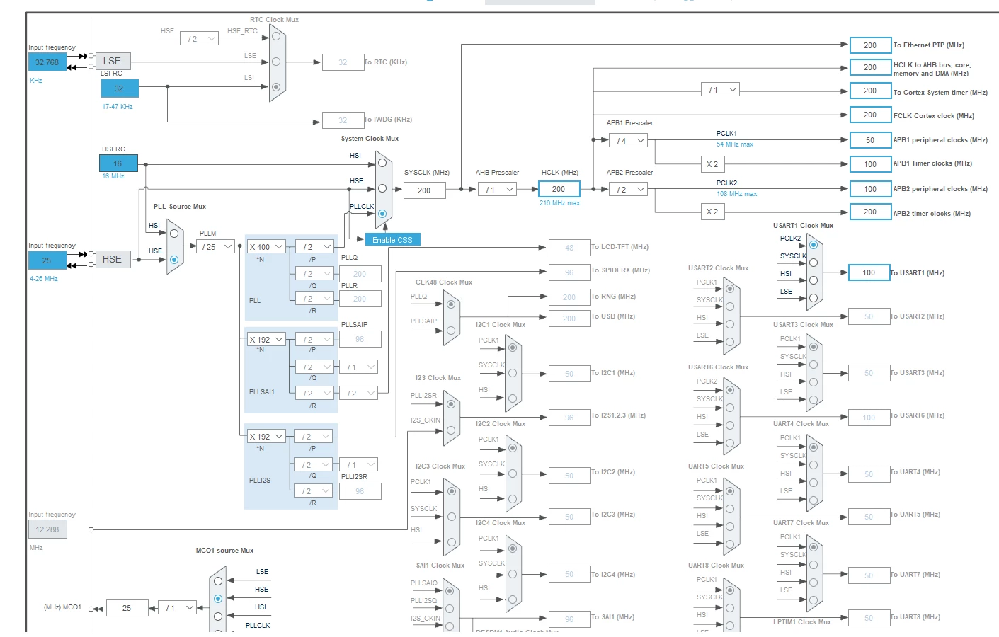

One explanation may be, that your system clock frequency is lower without the debugger connected. Output SYSCLK onto MCO.
VMiki.1
VMiki.1Author
April 27, 2022
I've verified that SYSCLK is 200MHz via MCO1 (SRC PLLCLK) whether the debugger plugged in or not -- so the clocks are correct. Using Keysight scope w/ Tektronix 1103 TEKPROBE.

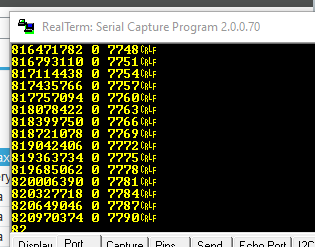

It appears the wfi instruction is the culprit, although I do not understand why and cannot find any explanation in either ST's user guide or in the ARM M7 Reference manual that would explain the "pause" of the CYCCNT. I put together a very basic application that only turns on USART1 and CYCCNT.
The program is clocked to 200MHz and just outputs CYCCNT and SYSTICK count to Serial after a WFI instruction. The more WFI instructions I add, the more of a pause I get in CYCCNT. For instance, with two WFI instructions, CYCCNT/SysTick gets me ~106MHz, while one WFI instruction gets me ~161MHz. This is with the debugger not running. Once the debugger is running I always get the correct CYCCNT.
Clearly I'm missing something, but I cannot find any reference material that explains this behavior (if it is expected). The same WFI instruction is used on my F4 projects to calculate cpu load by keeping track of CYCCNT in WFI (boiler plate as I understood it).
Without debugger:
With debugger:
