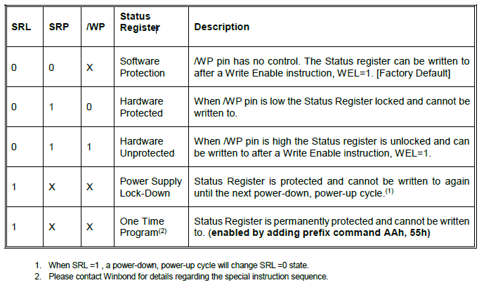

What does this "This seems to work." actually mean? Did you check WEL was successfully set (by reading the status register) or do you merely think it should be set?
There a lot of other registers and the chip id. Can you actually read all of them and do you get sensible values? Check in particular the protection settings, i. e. SRP, SRL, and the status of the WP pin.

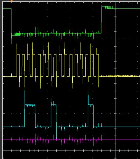

 "This seems to work."  means I check the signal of the command31h(Register-2 Write) on a oscilloscope.

I have been checked SRP and SRL was been OFF by reading the Status Register-1 and Status Register-2 commands.

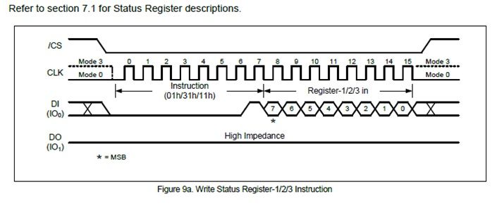

There is one additional point: After trying to program status register 2 (or any other programming instruction), the WEL bit must *automatically* revert to 0. So if it remains 1,
the write hasn't been accepted for some reason. If the write enable command was accepted (i. e. WEL changed to 0) but setting QE to one fails despite correct transmission, I'd suggest you check whether status register 3 is writeable using the *exactly* same setup but using 0x15 and 0x11 instead of the 0x35 and 0x31 instructions. DRV0 and DRV1 can be (re-) programmed several times without causing trouble if the SPI clock is rather slow.
If these bits can be successfully programmed and verified, but QE can't, then ... Well, there are several versions of W25Q16JV around, in particular regarding the QE bit. Althought the datasheet doesn't mention a version with QE permanently set to 0 (or not present at all), it's quite possible such versions exist. The W25Q16 is quite old design, maybe you've got an early revision that does not implement QPI mode at all?

I have solved!!!
I confirmed that using the command 01h am been able to set the QE bit (Register-1 and Register-2 write at the same time).
I do not know that not be able to set by the command 31h.
I could not find such a description in the manual.
