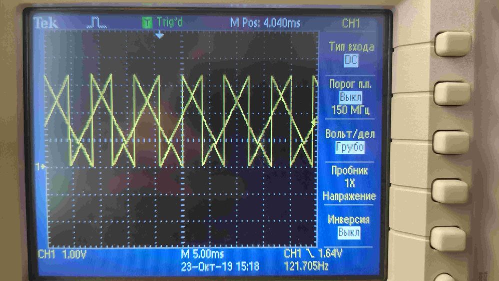

I am trying to control the amplitude of a triangle wave, while the frequency of the waveform should always be 1kHz. Is this possible to do?

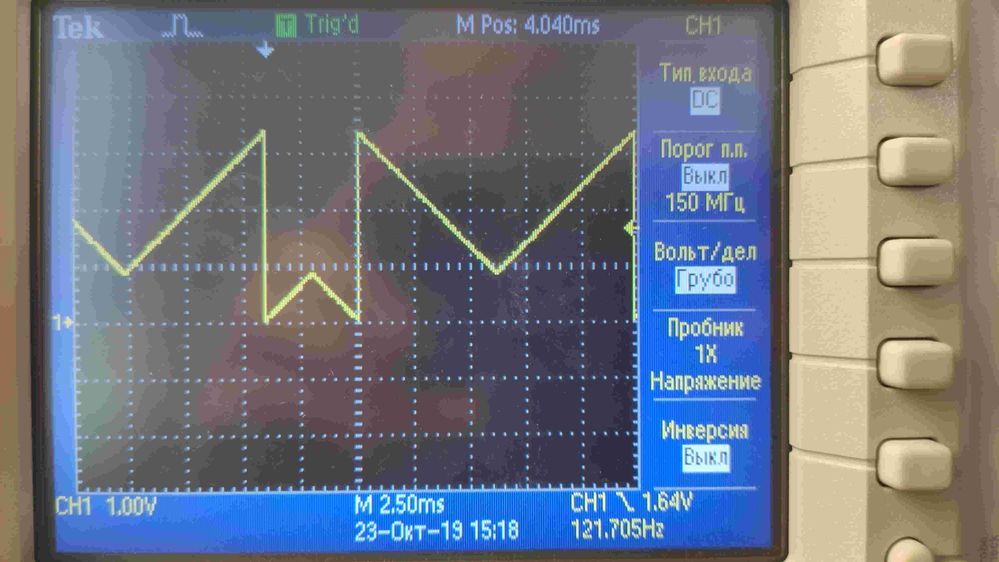

The reference manual says that I can control the amplitude of the signal using the register DAC-> DHRx. Further, to remove the DC, I use a ceramic capacitor, but when I write to register DAC-> DHRx a number any but 0 there, I get some kind of nonsense ...
I set the first channel for the event from TIM6 to the DAC, but I can not adjust the frequency of 1 kHz.

Is it even possible? Or if I change the value of the DAC-> DHRx register, will the frequency also change?
In general, what solution can there be to change the amplitude of a triange wave with a frequency of 1 kHz?

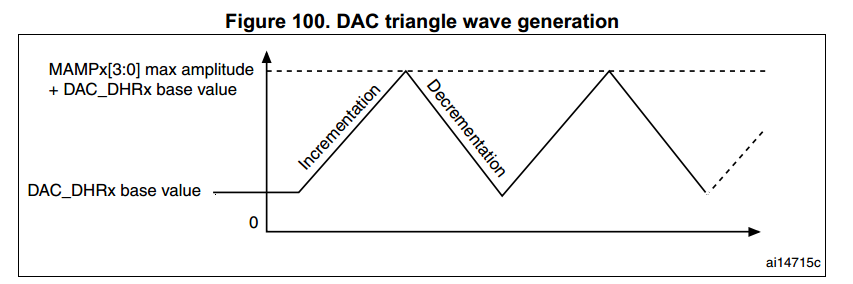

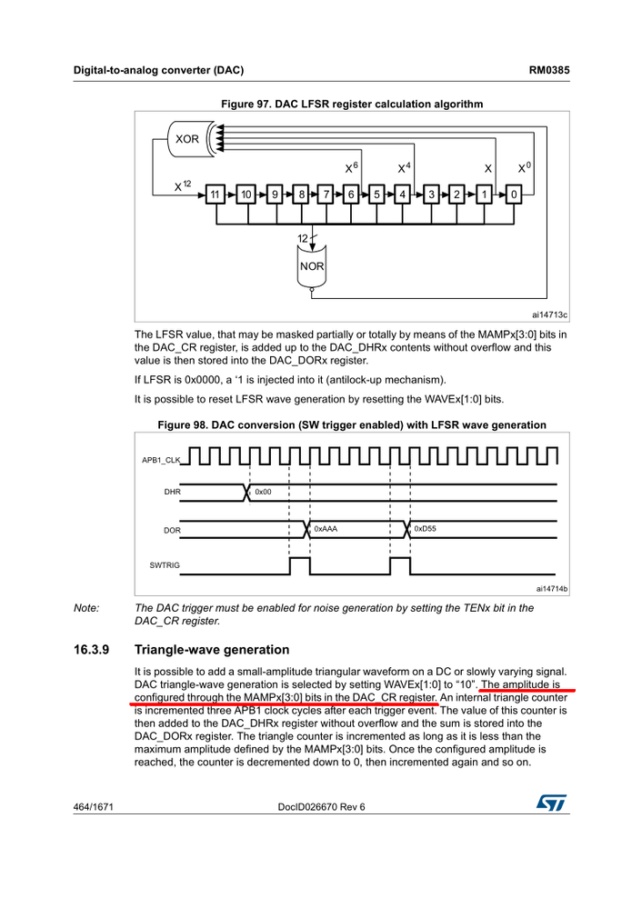

No, it does not.
So, amplitude can be changed changing MAMPx, but apparetly only when you disable DAC, i.e. not on the fly. Due to the simplistic way how the triangle generator works, it will change the frequency, too, so you'll need to compensate by changing the triggering timer's settings.
Read thoroughly the Triangle-wave generation subchapter of the DAC chapter.
