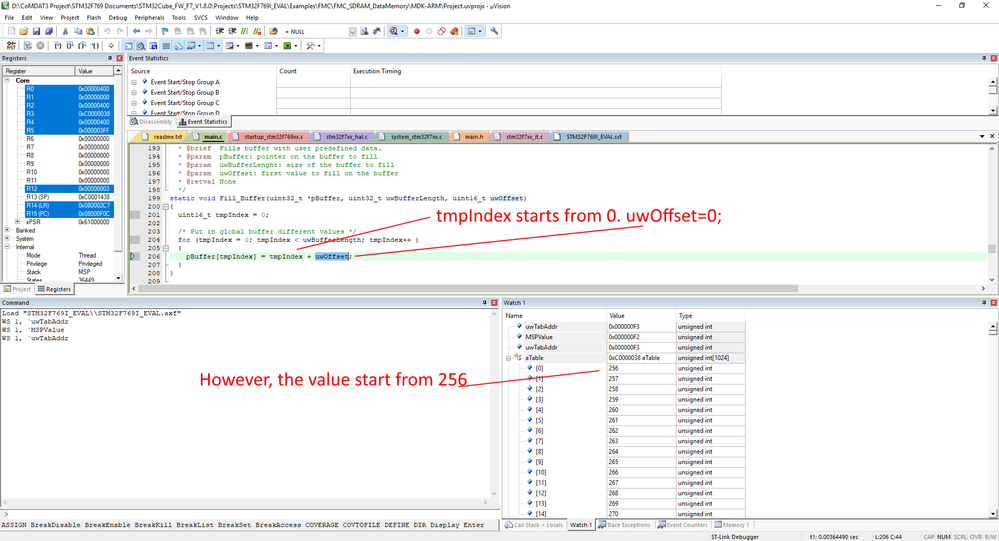

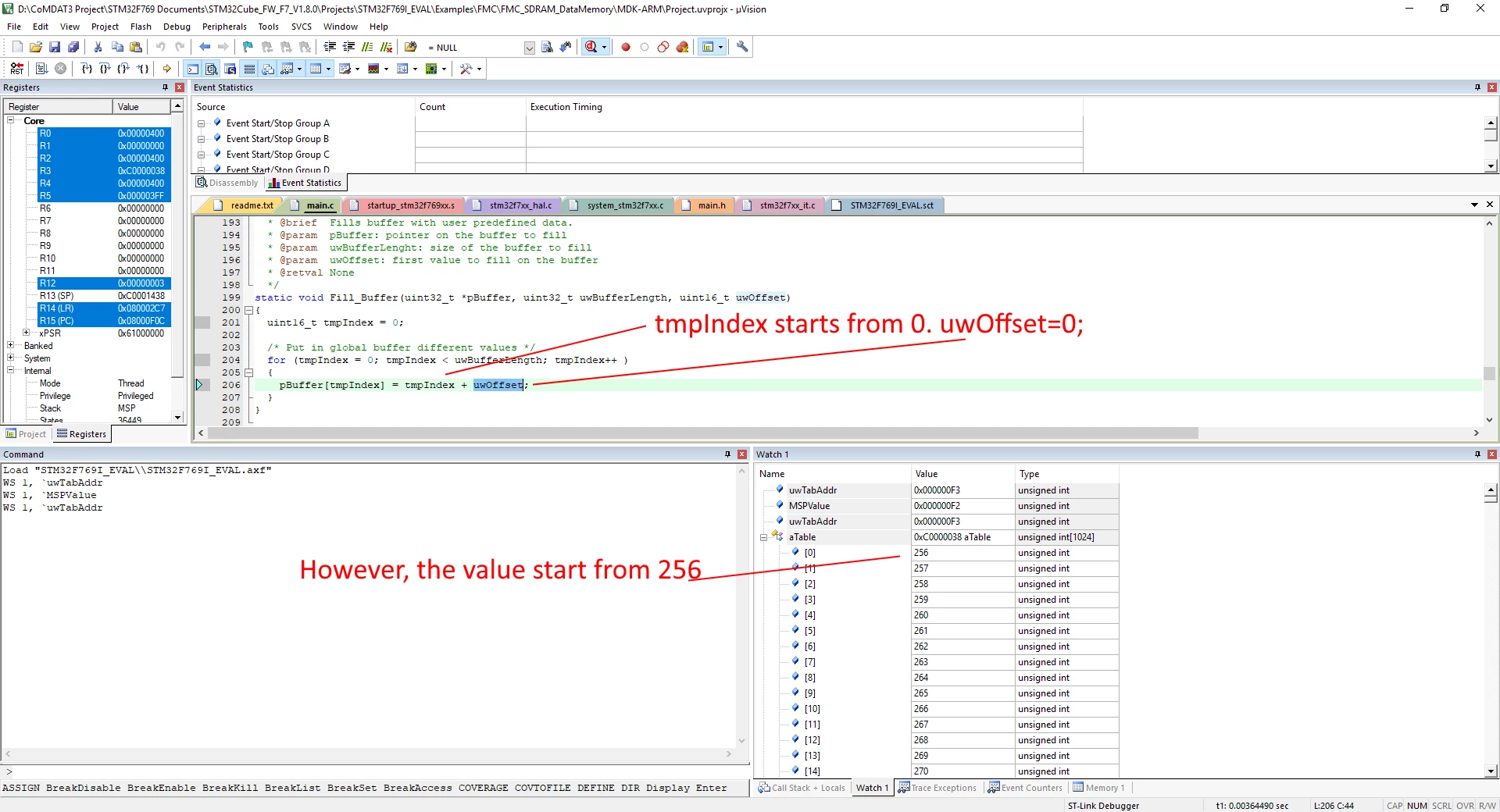

I tested FMC_SDRAM_DataMemory Example of STM32F769I_EVAL.
I found out that the data written to SDRAM is not correct.
See below picture for your checking. I believe HAL and FMC driver in system_stm32f7xx.c is not correct. Please advise me how to make it correct. Thanks.

I'd probably have the "Memory 1" window dump 0xC0000000 as 32-bit unsigned words. If everything has bit 8 set, I would look at the schematic critically and make sure no other use for D8 is specified or jumpered on the board.

THIHA KYAW
Just modify below and work for me.
/* Configure and enable SDRAM bank1 */
 FMC_Bank5_6->SDCR[0] = 0x00001964; //0x000019E5;
 FMC_Bank5_6->SDTR[0] = 0x01116461; //0x01116361
