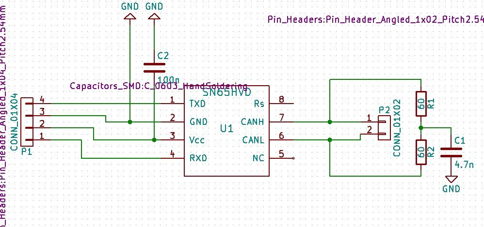

2) Heres schematic of CAN implementation:
On the right hand side there are Tx, Rx, GND and Vcc. Vcc is solid 3.29V. On the left there are CAN H and L. When I probe either CAN H/L I see contineus 2.3V voltage. No differential signal, nor any signal at all. At first I had problem with Vcc, that was 2.96V, under the abs.min. 3.0V. Then the voltage on these lanes was bit lower 2.1V. Why does this transreceiver transmit data to the bus side?
I am quite lost with this one. I cannot see anything wrong with my eyes.

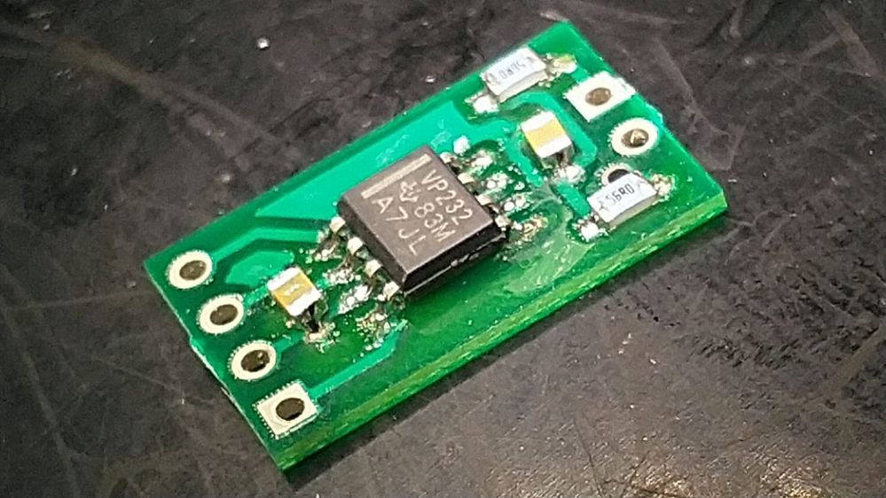

Here is a picture of this marvelous piece of HW. I haveruled every HW bug out except that TI chip itself is broken, but it was hand soldered straight from the reel so this should not be the case.
‎2018-06-28 2:04 PM
There is nothing connected to the bus. Nothing should be replaying it back. The point where this is measured is between MCU and TI. After TI only thing that I can see is steady 2.3V.

SN65HVD230 and SN65HVD231:
RS : Mode select pin: strong pull down to GND = high speed mode, strong
pull up to VCC = low power mode, 10kΩ to 100kΩ pull down to GND = slope control modeis your RS pin floating ?

Yes, that pin is not connected. But that does not matter since I am using SN65HVD232. That version does not support slew rate control.
‎2018-06-29 1:53 AM
Yes, this way I cannot communicate with anyone since bus is empty. But whether there is device(s) on the bus or not the transreceiver should do its purpose to generate differential signal to the other side of the bus, shouldn't it? Signals that I could see with oscilloscope. Am I missing something critical here? There is termination implemented (measured 118 Ohm vs 120 Ohm ideal) so electrical connection should be good. There is no need for device on the other end of the bus required for the driver to kick in.
