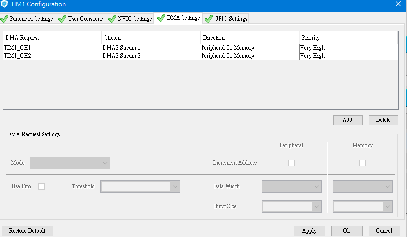

MCU: STM32F446RE
BOARD: NUCLEO-64 STM32F446
STM32 CUBEMX Version:4.20.0
Library: STM43F4 1.15.0
The problem here is probably hal driver.
I am currently setting TIM1 as PWM Input mode following the examples in STM32Cube_FW_F4_V1.15.0
In the beginning, I am using IT like in the example, it works fine.
However, the pwm signal I want to measure runs at 800KHz.
This forces me to use DMA method to capture the values of TIM_CC1 and TIM_CC2.
the settings of TIM1 DMA is as followed:
After generation of the project,
I thought that the following code would start the dma data moving:
HAL_TIM_IC_Start_DMA(&htim1, TIM_CHANNEL_2, (uint32_t *)IC2_Buf, IC_PREXFER_COUNT);
HAL_TIM_IC_Start_DMA(&htim1, TIM_CHANNEL_1, (uint32_t *)IC1_Buf, IC_PREXFER_COUNT);
But it does not work as:
HAL_TIM_IC_Start_IT(&htim1, TIM_CHANNEL_1);
HAL_TIM_IC_Start_IT(&htim1, TIM_CHANNEL_2);
Because inside the HAL_TIM_IC_START_DMA(), there is some code controlling timerHandle state:
HAL_StatusTypeDef HAL_TIM_IC_Start_DMA(TIM_HandleTypeDef *htim, uint32_t Channel, uint32_t *pData, uint16_t Length)
   /* Check the parameters */
   assert_param(IS_TIM_CCX_INSTANCE(htim->Instance, Channel));
   assert_param(IS_TIM_DMA_CC_INSTANCE(htim->Instance));
  if((htim->State == HAL_TIM_STATE_BUSY))
      return HAL_BUSY;
  else if((htim->State == HAL_TIM_STATE_READY))
      if((pData == 0U) && (Length > 0))
         return HAL_ERROR;
      else
         htim->State = HAL_TIM_STATE_BUSY;
This meas that if I call HAL_TIM_IC_Start_DMA(&htim1, TIM_CHANNEL_1,...) first, the htim1 would be in HAL_BUSY state, therefore I cannot successfully call HAL_TIM_IC_Start_DMA(&htim1, TIM_CHANNEL_2,...) accordingly.
I tried to comment out those hal_state checking codes, it seems to work nicely, for I got my ICx_Buf data as expected.
So, is that a bug confirmed?
Or DMA simply can NOT work like that as I need?
Please help me!

    I just realized that I cannot just comment out those HAL_TIM_STATE codes and let DMA work asynchronously!
    So I have to manually configure the htim1 like this:
    htim1.hdma[TIM_DMA_ID_CC1]->XferCpltCallback = TIM_DMACaptureCplt;
    htim1.hdma[TIM_DMA_ID_CC2]->XferCpltCallback = TIM_DMACaptureCplt;
    HAL_DMA_Start_IT(htim1.hdma[TIM_DMA_ID_CC1], (uint32_t)&(htim1.Instance->CCR1), (uint32_t)IC1_Buf,                         IC_PREXFER_COUNT);
    HAL_DMA_Start_IT(htim1.hdma[TIM_DMA_ID_CC2], (uint32_t)&(htim1.Instance->CCR2), (uint32_t)IC2_Buf,                      IC_PREXFER_COUNT);
    __HAL_TIM_ENABLE_DMA(&htim1, TIM_DMA_CC1);
    __HAL_TIM_ENABLE_DMA(&htim1, TIM_DMA_CC2);
    TIM_CCxChannelCmd(htim1.Instance, TIM_CHANNEL_1, TIM_CCx_ENABLE);
    TIM_CCxChannelCmd(htim1.Instance, TIM_CHANNEL_2, TIM_CCx_ENABLE);
    __HAL_TIM_ENABLE(&htim1);
    Now I both have the ICx data and they collect synchronously.

    Hello All,
    I met the same issues. Is it still in progress or is there a solution for this?
    I also had to change timer state forcibly before calling 2nd HAL_TIM_IC_Start_DMA() like below
    HAL_TIM_IC_Start_DMA(&htim1, TIM_CHANNEL_1, caputure1, 2);​
    htim1.State = HAL_TIM_STATE_READY;
    HAL_TIM_IC_Start_DMA(&htim1, TIM_CHANNEL_2, caputure2, 2);
