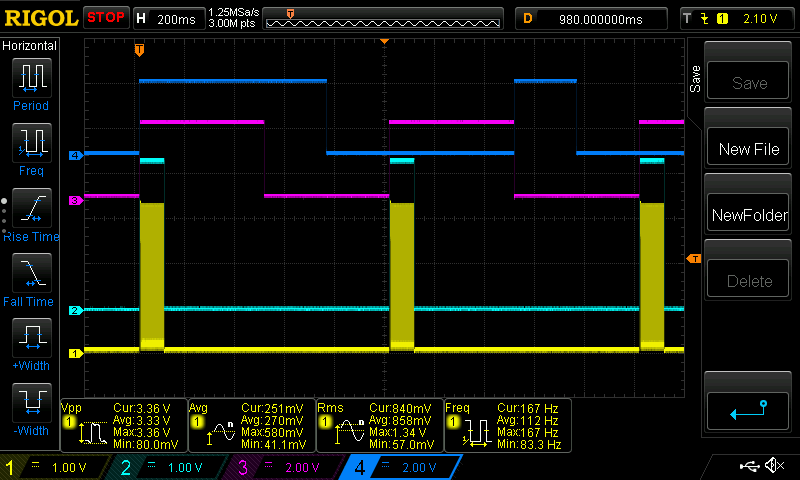

I'm using a Nucleo F446ZE to test timer capabilities to make a peak-and-hold PWM driver. I already have the core functionality where TIM1 uses DMA to run through a buffer of variable duty cycles at a higher frequency (e.g. 5 kHz) for the high-side mosfet. TIM2 is triggered by TIM1 to produce a synchronized signal that is low frequency (e.g. 1 Hz) for the low-side mosfet.
The problem I have now is making a third timer output that is synchronized to the first two but with a programmable phase shift. In reality I do have code that will make a synchronized, phase-shifted signal as shown in the image but there is an issue.
Image legend: TIM1 high-frequency (yellow), TIM2 low-frequency (cyan), TIM2 phase-shift falling-edge trigger (magenta), and TIM3 phase-shifted signal (blue).
What’s supposed to happen is that the blue line goes high on the falling edge of the magenta line, as seen in the 2nd half of the scope image. And this method does work except for the very first output cycle as seen in the 1st half of the scope image; the blue line goes high with all other timer outputs instead of being delayed.

I just can’t figure out why the blue output is starting early for the first cycle. I tried changing the order of enabling the timers and capture compare channels, but that didn’t work. I also tried clearing the TIM2 SR_CC1IF, SR_TIF and EGR_TG bits just in case the TIM2 trigger output was being fired, all to no success.
I know there are other threads here that show using one pulse mode to do this. I tried that, but the problem is that there is a minimum non-zero delay with one pulse. I’m using this with a high-speed camera, and the majority of my time I’ll need no delay so that won’t work. This solution has no delay when programmed to do so, except for the first pulse.

Are you saying the timer outputs at its default polarity (high in this case) until it receives the trigger, hence it starts once CCxE is enabled? I think I understand that can be fixed by preloading CCxE, so output won't be enabled until the timer is triggered. Only the advanced timers have CCPC and CCUS bits, so I'll have change TIM3 to 1 or 8.

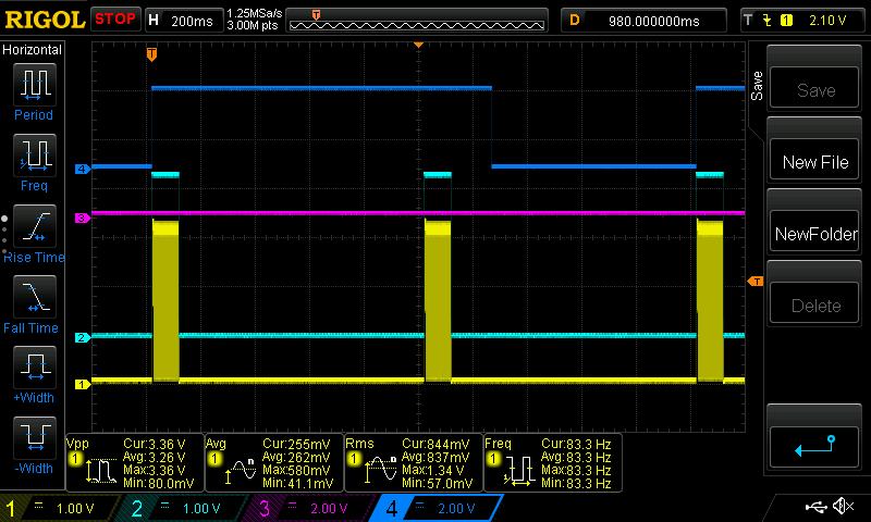

I don't know if this changes the situation, but when I set TIM2 CH1 (magenta line) CCR to 0 to have zero delay on the phase-shift signal (blue line), the signal stays high the whole 1st cycle so there is no rising edge on the 2nd cycle. The 3rd cycle on everything is good.

I made a little head way with this. I believe you are right that when I set CCR1=0 (0 phase shift) there's no trigger on the first cycle. If I set a delay of CCR1=1 then the phase-shift signal stops in the first cycle stops when it's supposed to instead of continuing into the second cycle.
I also figured out that for non-zero phase shifts the early high pulse (image in original post) is due to enabling the TIM3 capture compare channel. I tested this by setting the phase-shift trigger to have a delay of 500ms and started TIM1 and TIM2. I then did a HAL delay of 400ms and enabled TIM3 capture compare channel. At that point the signal went high, which is 100ms before the TIM3 trigger. This further suggests I need to look into your earlier suggestion of using CCxE preloading.
I tested setting TIM3 CNT=ARR. It worked as you thought, but TIM3 was delayed by 1 CNT value for all cycles. In my timing setup that's 100us, which is too large for the application.

In the case of 0 phase shift, I simply change the timer trigger to TIM1 (ITR0). With this it outputs on the first cycle and is synced to the other timers.
