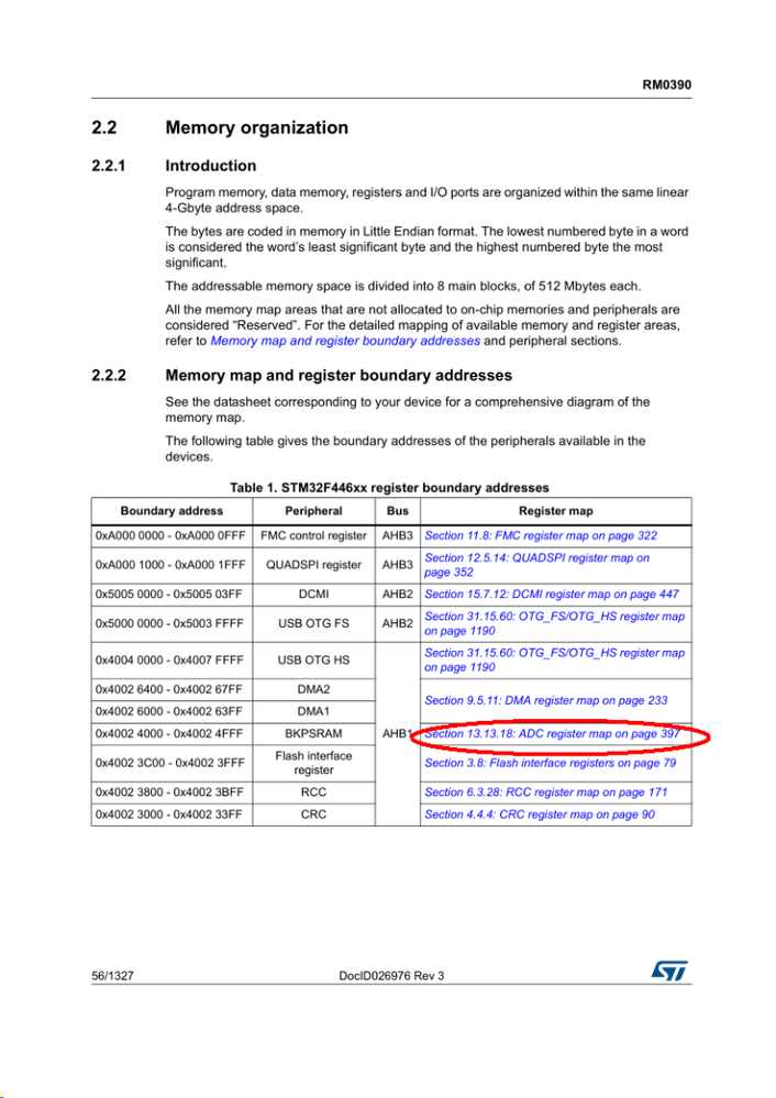

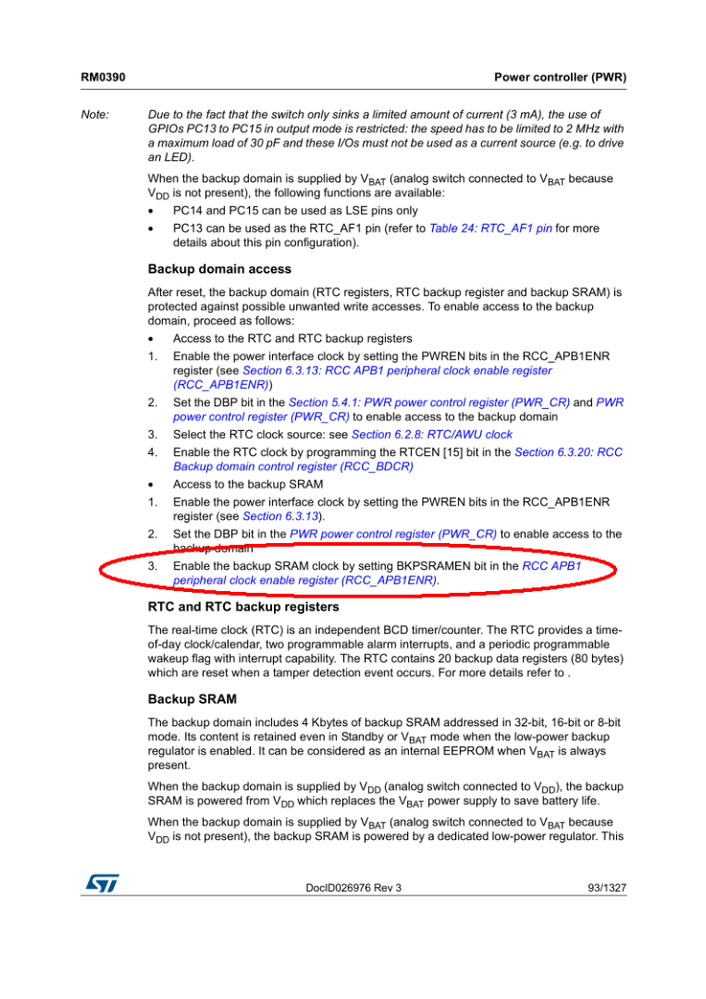

ADC is irrelevant.
Should be RCC AHB1 peripheral clock enable register (RCC_AHB1ENR).

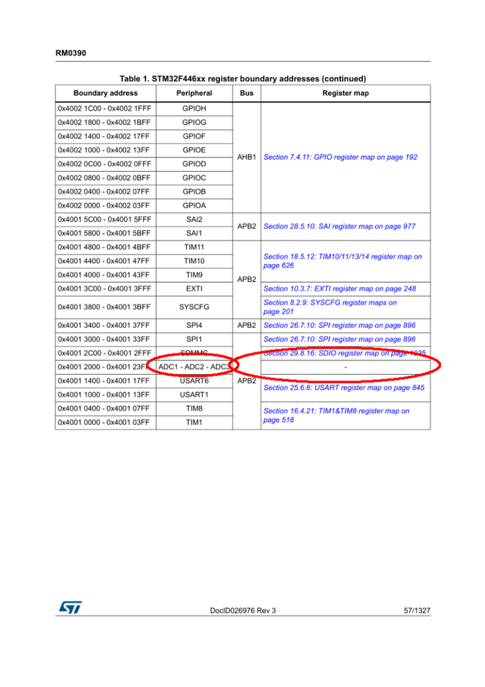

The ADC reference/link from the first picture I posted above should probably go here:

Hi Jan,
All the errors you highlighted are reported internally.
Thanks again!
