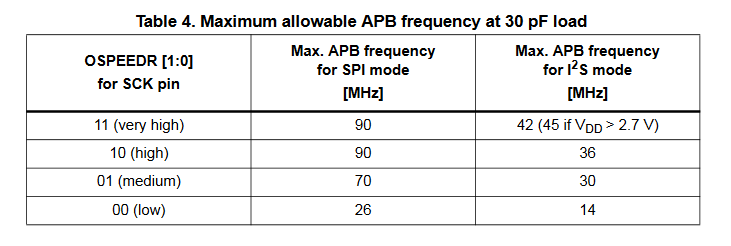

I was studying the errata sheet for my uC (STM32F427ZI) and found this entry:
Corrupted last bit of data and/or CRC, received in Master mode with delayed SCK feedback
For the possible workarounds a table with the maximum allowable APB frequency is listed.
But my problem is, that on my SPI channel I have 70pF load. So now I don't know how to setup my SPI channel to avoid the corrupted last bit.
Does anybody have some informaton about this?

Well, it's more-less an RC constant of the output transistor's full-open resistance and the load capacitance, which delays the SCK, so with OSPEEDR set on SCK to high you should restrain the respective APB to 90MHz/(70pF/30pF).
Or change the hardware design.

No. Actually I said that you should run APB below 90MHz/(70pF/30pF) = 38.6MHz.
