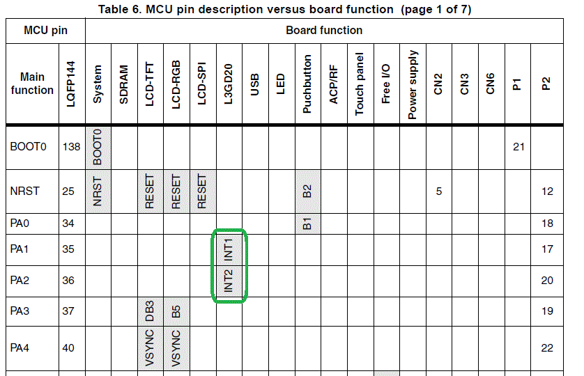

Unless you've addressed them, there are a number of physical pin conflicts on the STM32F429I-DISCO
Line numbers make it undesirable to test the code.

I have created little test app for TIM5. Channel 1 and 4 are working, Channelse 2 and 3 not. Source code:

Isn't there just a pin conflict you aren't dealing with?
marjano89
marjano89Author
June 18, 2014
Posted on June 18, 2014 at 07:57
It might be this, but how can I get rid of this conflict? This is not enough?:4
