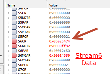

  1. Stream6 NDTR is 0xff82 which suggests to me it pushed more data than the 128 transactions it was instructed to transfer (I'm of the belief that DMA_HISR_TCIF6 fires when NDTR == 0) -- see picture below

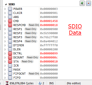

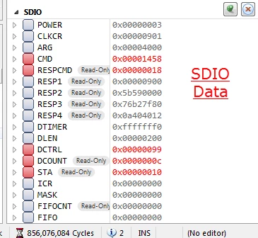

  2. SDIO DCOUNT is 0x000c - which says it expects 12 more bytes. It's loaded based on the Block size of 512 and then counts down as data is transferred.-- see picture below
  3. SDIO FIFOCNT is zero so all data has been transferred. -- see picture below

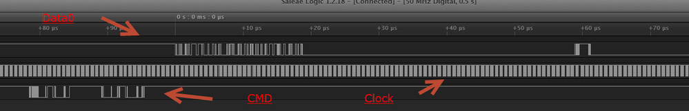

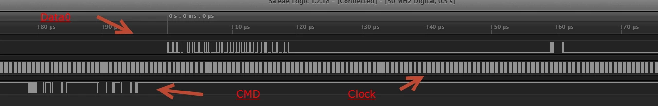

My code is posted below. If someone can help identify what I'm doing incorrectly I would appreciate it. I also have pictures below of the DMA and SDIO register states and a trace of the SDIO CLK, CMD and Dat0 lines for the write process listed. The trace shows 2 commands. the first is a SDIO CMD 13 for status followed by SDIO CMD 24.

Can anyone share some light on the following:
  1. DMA NDTR set to 128 transactions - why is the NDTR register at 0xfff8 when the end of transfer interrupt fires? To me - that says the DMA made 255 transactions (128 count down to zero and then another 127 to get to 0xff8).
  2. If the DMA made the 128 transactions (128 32-bit words = 512 bytes) - why does the SDIO DCOUNT show 0xc which to me says it is waiting for 12 more bytes (or 3 more 32-bit transactions) to complete its Block Write?

I'm having exact the same problem with communicating per DMA to my SDIO. But the problem only appears very seldom.
For example DCOUNT is set to 0x200 so 512 Bytes and FIFOCNT is already down to zero.
