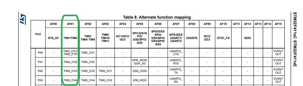

2022-11-03 9:26 AM
> GPIOA/B ports are enabled, set to input
They have to be set to AF in GPIO_MODER, and the appropriate AF number set in respective GPIO_AFR[].
If still in doubts, read out and post all the relevant registers content. And since you know how to program properly using registers, ditch Cube/LL, it's just an unnecessary intermediary.

2022-11-03 9:49 AM
The AF setting is a pin mux, associating a pin with a controlling peripheral
The setting is 4-bit allowing for up to 16 options.
PA1 would be GPIOA->AFR[0], bits 4 thru 7
GPIOA->AFR[0] = (GPIOA->AFR[0] & 0xFFFFFF0F) | (1 << 4); // AF1 on Pin 1

Oh, I see! So setting GPIOA->AFR[0] is the AFRLow and GPIOA->AFR[1] is the AFRHigh?
2022-11-03 11:00 AM
Thank you so much, your comment with the clarifications below from other folks was the one that got it working.
For anyone who googles this later, ChA and ChB of my encoder were connected to PA0 and PA1, and those port/pins were configured with AF01 to be TIM2_CH1 and TIM2_CH2 respectively. The code block is:
RCC->AHB1ENR |= RCC_AHB1ENR_GPIOAEN; // Enable RCC GPIOA
GPIOA->MODER |= 0xA; // Set PA0 and PA1 to MODER 0b10 for AF
GPIOA->AFR[0] |= 0x11; // Set PA0 and PA1 to AFR01 (TIM2_CH1 and TIM2_CH2)
RCC->APB1ENR |= RCC_APB1ENR_TIM2EN; // Enable RCC TIM2
TIM2->CCMR1 |= (TIM_CCMR1_CC1S_0 | TIM_CCMR1_CC2S_0); // set CC1S/CC2S to 0b1
TIM2->CCER &= ~(TIM_CCER_CC1P | TIM_CCER_CC2P); // set CC1P/CC2P to 0b0
TIM2->SMCR |= TIM_SMCR_SMS_0 | TIM_SMCR_SMS_1; // set SMS to 0b011
TIM2->CR1 |= TIM_CR1_CEN; // Enable TIM2 operation
