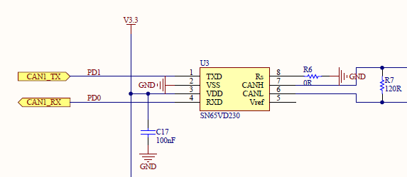

I have the same Problem. I have already tested various programs. I have started with the CubeMX and its configuration, went over to the StdPeriphLib. I only tested to send something from the Discovery to a Vector CAN Interface. I also watched the tx pin with a scope and recognized that tht tx pin at the STM goes from low to high when program starts and then never does anything.
I am using Keil uVision in its latest Version.
I am very confused that the pin isnt doing anything.
Attached is my cubemx main file.
