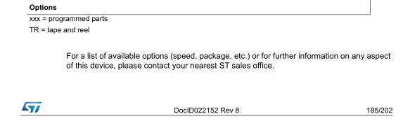

I've been using STM32F405R processors on my boards for a while. I once figured out what the numbers and letters after the R mean, but they were not of any importance to me. (I have plenty with 512Mb flash).
This time when ordering a new batch of '405 processors, they (farnell) are offering the STM32F405RGT6V and the 'V' here was new to me. So I looked things up in the datasheet. There it says something like: 'xxx' packaging options like TR for tape and reel.
I would like to be sure that it doesn't mean something like 'cheaper version without the second and third ADC'.
Roger.
    Best answer by re.wolff9
    Posted on June 07, 2017 at 08:49
    Answer from ST:
    The V at the end means that ST paid the MP3 licence for that processor.

    There it says something like: ''***'' packaging options like TR for tape and reel.
    No, it says ''programmed parts''.

    Yes, ok, the point is, it says 'xxx = programmed part, TR= tape and reel' but nothing about 'V'.

    Basicly it says 'it's a customized part - if you don't know what it is, don't buy it'.

    Yeah. Basically, the datasheet is telling me it is a programmed part for a specific customer. But that makes me wonder:
    http://nl.farnell.com/stmicroelectronics/stm32f405rgt6v/mcu-32bit-cortex-m4-168mhz-lqfp/dp/2333282
    ... why is farnell selling preprogrammed parts for a different customer????
    Even if that is the literal reading of the datasheet, I'm still guessing that it is more likely that ST forgot to document (where I can find it) what that V means. That's why I'm asking....

    Answer from ST:
