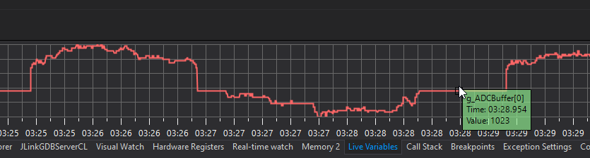

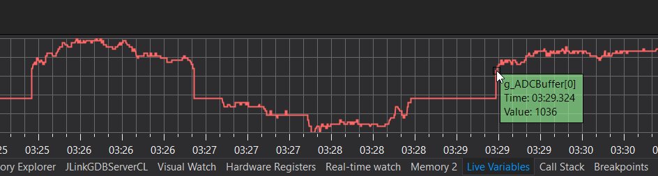

This is a zoomed in graph of the output values, even with the noise the value between 1023 and 1036 can't be reached.

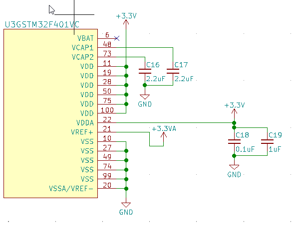

Schematics looks good. The devil may be in details, i.e. layout. By measuring directly on the pins, exclude layout/PCB errors and bad solder joints.
I'd recommend to connect VBAT to VDD (as is recommended in DS), but I don't believe that's the root of your problem.
> Vref is the output of a NCP51460, it has no decoupling at its output though.
As an experient, add some, as close to the VREF+/VSSA pins as possible.

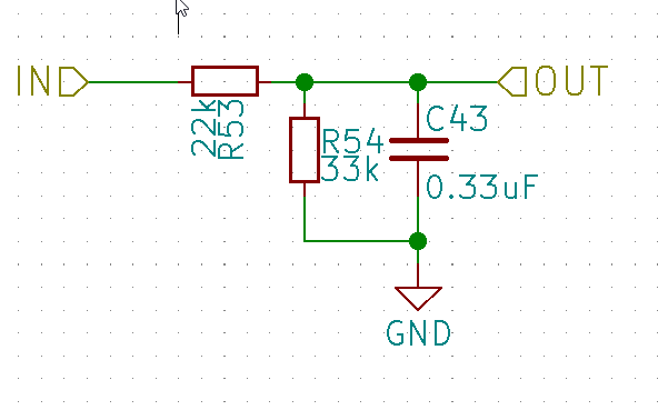

One good detail is that the input stage is unbuffered :

I would suspect the board design - are *all* VSS and VDD pins sonnected, including VDDA/VSSA? Is VSSA/VDDA somehow filtered? How exactly is VREF+ connected/filtered? How are all these pins decoupled?

See the picture above ! Missclicked the reply button
2020-05-29 05:03 AM

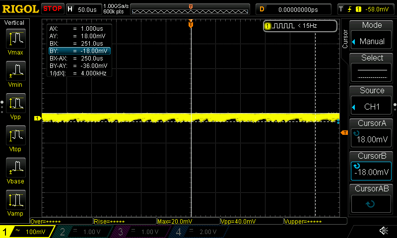

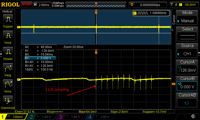

Since we wanted to inspect the behavior ( for educationnal purpose :) ) we removed it and scoped the Vref pin and look what we have found :
Almost 100mV drop when sampling
The Vref uses an ncp51460 to get its reference. In the ref design there's not decoupling cap but ... seems that it need some to sustain the sampling load.
It has been a great learning experience, thanks everybode for all your input !
