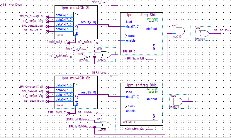

OK, if you need random access to the data in the FPGA then the FSMC interface looks like the best option.
However, if you are accessing the data sequentially (or even discontinuous sequentially) then the extra pins taken up by the address bus seem a waste of pins to me, unless you have the pins to spare. In my case I use the the FPGA's connected to cameras and the information I want from them is either the whole or a block of the image, the resultant data or the JPEG data. I use a programmable counter within the FPGA to generate the address value and an edge triggered signal to update it. The data passed over SPI is status data so I can detect events without having to address and read a register. Which I think is the optimal solution to my application, but am always happy to consider alternatives :) Vive La Forum.- Mark as New
