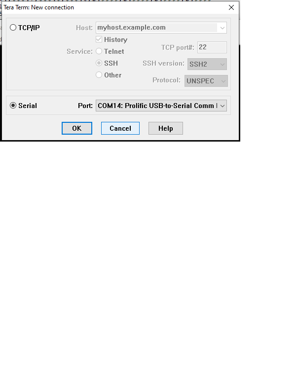

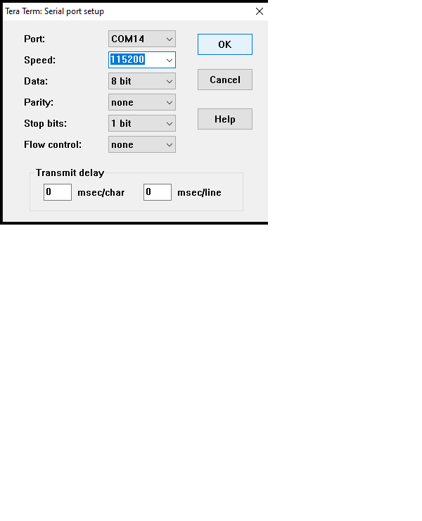

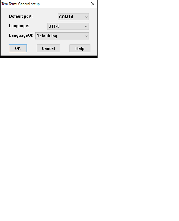

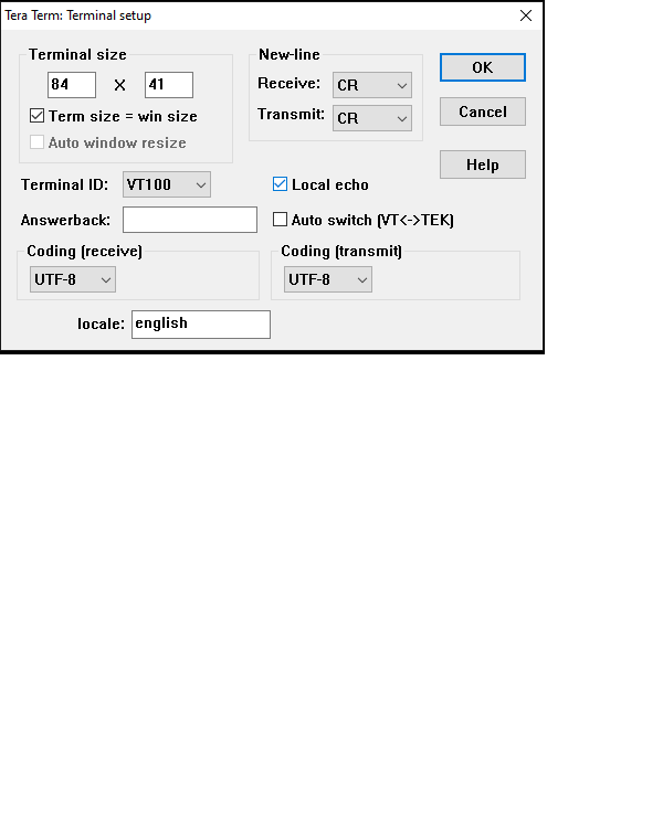

I want to use teratern to send a string to my usart on stm32f4, but nothing is received.
these are the settings of my teraterm

I intend to receive a string from using the code below:
HAL_UART_Receive(&huart3, (uint8_t *) usartReceiveBuffer, sizeof (usartReceiveBuffer),100);
However, I can not receive anything from Teraterm.
I can, for example, receive data from Hterm, but not from teraterm.
Please help is you can.

But according to the screenshots, hterm operates in VT100 mode, i.e. it emulates the behavior of a old mainframe terminal.
Those therminals used to operate line-based, not character-based.
Try setting it to a raw mode, without any character preprocessing or interpretation.
I'm using Linux for such stuff, not familiar with HTerm. I had worked with PuTTY once, which has such a raw mode.
Piranha
Principal III
February 18, 2020
Screenshots are from Tera Term and basic text printing should work in VT100 mode also.

> It's not clear to me what you mean here.
sorry I think i was not very clear about this.
I have designed an interface using USART which takes the user input and starts the program. It uses the following code to take data from USART.
while (whileLoopFlag [1] == 1)
	memset(usartReceiveBuffer,0,sizeof(usartReceiveBuffer));
	HAL_UART_Receive(&huart3, (uint8_t *) usartReceiveBuffer, 255, 100);
	if (strcasecmp(startMeasString, usartReceiveBuffer) == 0){
	 printChooseMsrmntMethodMenu();
	 whileLoopFlag [1] = 0;
	 whileLoopFlag [4] = 1;
The code takes a string from USART and compares it with another string, and makes a flag one if the two strings match.
The program works on Hterm. When I enter data in the input section the program works.
However, on Tera Term it does not work. When I type data in Tera Term, the entered data is not seen.
I can only see the entered data when I turn on the local echo.
even after turning on the local echo, the entered data is not taken with the USART Receive, and it does not start the program.
I tried to add a "\r\n" in the end of my reference string, the string with which the entered string is compared, but this also does not work.
This is really confusing me, thank you in advance for your help.
