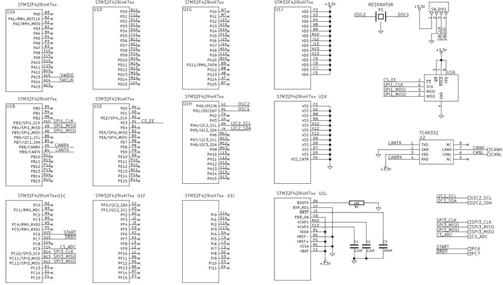

Posted on March 30, 2018 at 10:41
I am adding my schematic for info, could this be something to do with the internal regulator..?

Ah so it's BGA? Can't this simply be a case of bad joints on some of the supply/ground pins? Do you have multiple pieces of hardware exhibiting the same symptom?
Also, can't the 'resonator' be a source of temperature-dependent issues?
To be honest, I'm not exactly sure what it is doing.
So how does it fail short of expectations and what those expectations were? In other words, how do you know it 'stops running'?
In cases like these you should devise simple tests, run them and observe the results.
Posted on March 30, 2018 at 12:42
The resonator
The oscillator circuit is an analog thing, it may go awry with temperature-induced changes in its parameters - including the amplifier internal in STM32. In other words, the component may be good to 125deg.C but the oscillator as a whole system may fail.
What's it frequency? What's the system frequency? How do you use the Q tap of the PLL?
And you still haven't answered the main question, what are symptoms exactly and why do you think it's a failure?
Posted on March 30, 2018 at 18:17
>>Clive also mentioned FLASH LATENCY settings, but not sure what impact this will have on temperature...
The flash and the ART cache are critical paths in the design, and transistor speed is impacted by voltage/temperature
At 160 MHz I'd have
FLASH_LATENCY_
5, might work at
FLASH_LATENCY_4 but I like to round up fractions and most of the performance here is hidden by ART caching and prefetch paths.
A failure here results in deliver of bad data/instructions, the latter usually in a Hard Fault due to how tightly coupled things are.
