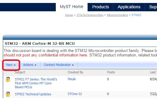

    Excuse me for being irrelevant, I'm new here and don't know how to create a new post! Can you guide me with that?
    Tesla DeLorean
    Guru
    November 19, 2016
    Posted on November 19, 2016 at 23:07
    Sign into forum
    Go to the ''STM32'' forum page, listing the threads
    Go to the upper left corner of the thread list, and click the ''New'' tab.

    kmehranh
    November 19, 2016
    Posted on November 19, 2016 at 23:38
    Thanks
