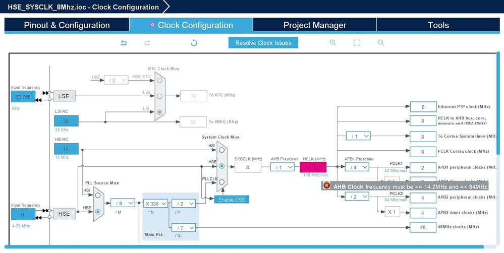

I am new user of ST Microcontrollers. I am using STM32F4 Discovery board.
Till now its default HSI oscillator I was using, now I am going to use the HSE clock of this.

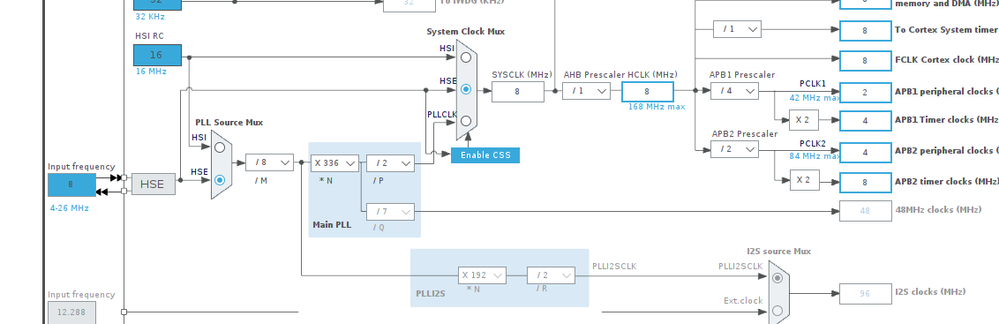

STM32F4 Discovery board have 8 MHz crystal, which is connected to the microcontroller. when I goto configure through STM32 CUBEMX configuration tool then it shows me a RED lndicator and it shows that clock must be greater than 14.2MHz.
Why it is so? Datasheet says that we can use clock frequency ranging from 4-26MHz.
Can someone explain me this? How to resolve this issue?
There is no issue - you just have to disable/not use anything, that needs a higher clock, like I2S, USB etc.

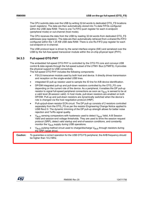

At such low AHB frequency you can't use USB.
A_H
I am not using USB feature right now. I am in learning phase and just want to check this HSE configuration.
Can I go with these settings?
for USB or any other peripheral definately I will use the higher clock.
