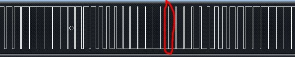

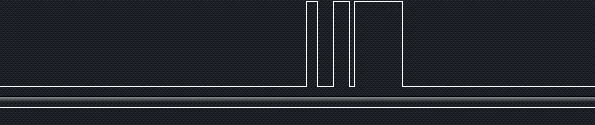

Hi.
I try to make DDS. The code is below. The idea is to get new value of capture-compare register after Update event. This is done in the update interrupt. I have the following problems: 1) I do not see zero in the train of pulses, while it is present in the array; 2) I see some pulses which should not be (I attached the images - in the lower one is shown the marked pule of the upper image, only one pulse has such artifacts others pulses are ok ).
How those problems can be solved?
Maybe I should use one pulse mode?
Thanks!

    Posted on April 07, 2015 at 18:34
    TIM4CLK != 4 *APB1CLK
    It would be twice the APB1 clock in the DIV4 case.
    You should confirm and clear the Update interrupt, and definitely clear the Update source well before you exit the handler, as there is a race hazard here in the way the NVIC/TIM and tailchaining interact.

    Posted on April 07, 2015 at 22:28
    void TIM4_IRQHandler(void)
    static int i = 0;
    i++;
    if (i == 60) i = 0;
    TIM4->CCR1 = sinus[i];
    TIM_ClearFlag(TIM4, TIM_FLAG_Update); // <<< THERE IS A RACE CONDITION HERE AS IT IMMEDIATELY EXITS, DO IT FIRST ^^^
    Before the write propagates to the timer, to clear the interrupt, it remains pending in the eyes of the NVIC and the processor. When it leaves the routine, it will immediate re-enter via ''tail-chaining'' mechanism. You do not check the source, and your routine will run for a second time. You can save yourself grief, by a) checking what the source of the interrupt is, and b) clearing it before the body code in your routine executes so that it is actually clear by the time it leaves.

    Posted on April 07, 2015 at 22:35
    static int i = 0;
    if (TIM_GetITStatus(TIM4, TIM_IT_Update) == SET) /* Confirm it's an Update, VALIDATE */
    TIM_ClearITPendingBit(TIM4, TIM_IT_Update); /* Clear TIM4 Update interrupt pending bit, EARLY */

    baev_al
    baev_alAuthor
    April 8, 2015
    Posted on April 08, 2015 at 08:08
    I changed the handler to the above. Now I see zero among the pulses. But still the second pulse after zero pulse is wrong. I attached the pictures.
