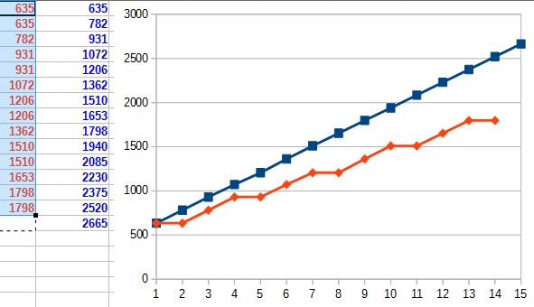

I'm sampling 12 channels at 1KHz,12 bits, i mean that every 1 ms i should have a new collection of 12 samples
The error is that ,for at least one channel ,the sequence of consecutive values is not correct:
I set a bench with a ramp waveform in a way that during the rise of the ramp every sample should be about 145 bits greater than the previous one,the collected values instead are showing some wrongly repeated values between right values,see image,of course the blue ramp-values are the right ones.I can say taht other ADCchannels are at values about 0 bits,because they are connected to VSS,so i reasonably claim that they are not responsible of values in the list
The problem happens even if i transfer the data in single mode or burst of 4
Is it a typical syntom of some trivial error?
I use circular buffer mode,FIFO treshold full,and i do almosto nothing on DMA interrupt,except collecting data,i don't flush the FIFO unless such stuff is done by the HAL_DMA_IRQHandler function
