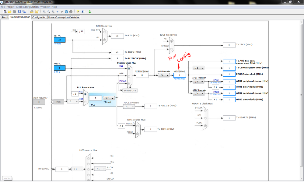

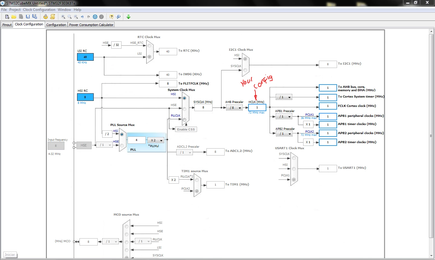

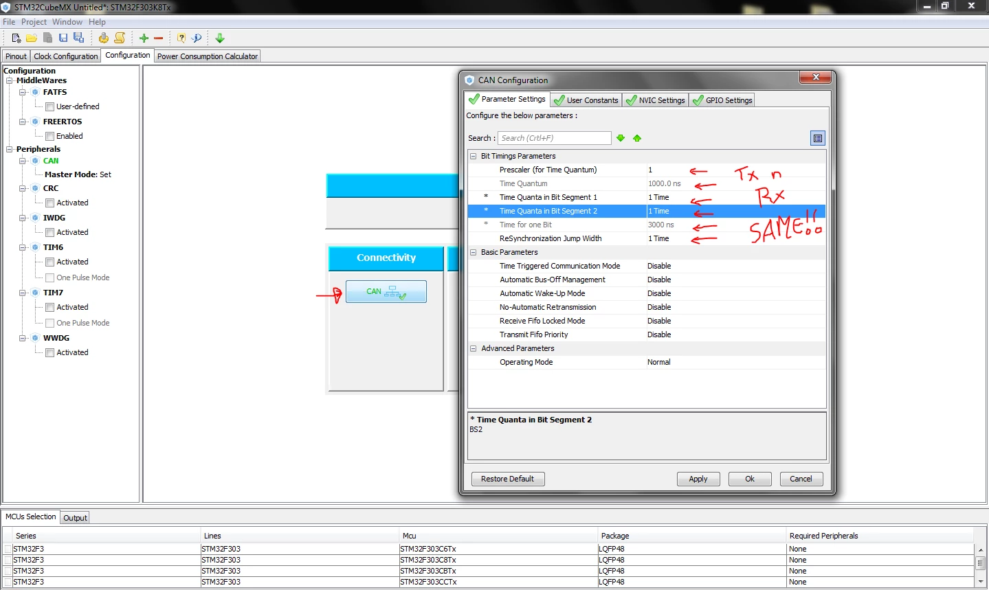

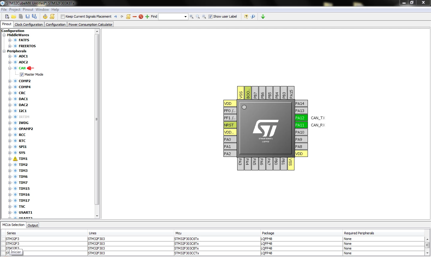

Other common issues are from time configurations, I suggest to you to use the CubeMX to inicialice the CAN port, in the clock tab make the configurations of the board clocks and crystals, and in Configuration tab set all the parameters well:

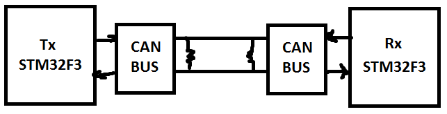

Some really really important is in the last image, you must to take on count that both Tx and Rx module must have the SAME configuration!, if one of them don't have the same configuration, the modules will never communicate well.
One last checking that is always important is to make sure that all the hardware is fine, remember to use the can bus chips in both modules, I'm using the
SN65HVD230 and works really fine, make sure that there is the 120ohms bus resistors, and if you have an oscilloscope check also the Tx and Rx signal, from both  MCUs and in the CAN bus.
abdou si
abdou siAuthor
April 29, 2017
Posted on April 29, 2017 at 12:18
Hi
thank you vert matche about your replying
first i am sure that my can works because i tested using mbed.h
i didn't understunde '
both Tx and Rx module must have the SAME configuration!'
how i can do it
abdou si
abdou siAuthor
April 29, 2017
Posted on April 29, 2017 at 13:27
i can config jut the CAN bus but i dont know how i can confugurat eche one alone
