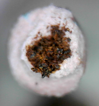

Posted on May 29, 2017 at 16:41
I am developing an application using a CAN bus and 2 differentMCU: STM32F407 and STM32F
The code for the STM32F407 works fine. Icanseedata on the bus using an oscillo.
However, the STM32F302 does not ack the message and does not transmit either.
The STM32F302 works in loop back mode, but in normal mode, I cannot get it to send data on the Tx line. the tx line is always high and the Tx Mailbox just stays full.
I suppose the problem is in the GPIO initialization, but cannot find the problem
Any help is welcome.

    Posted on May 29, 2017 at 19:15
    Reflect on the connectivity of the transceiver and bus. ie If not the code, then it's the hardware.

    franck23
    franck23Author
    May 30, 2017
    Posted on May 30, 2017 at 06:33
    Hi Clive,
    Yes, that was the hardware!
    It is what happens when you buy cheap pre-crimped wire for testing. One of the wires had rusty iron instead of copper...
    The code on the first post works fine.
    I have attached a close look of the wire below...
