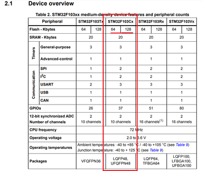

Hi all,
I've a board with the STM32F103C8T6 MCU.
My firmware has to handle a lot of IO, display and UART logic, nothing special but just a lot of logic.
So the 64K b internal flash memory is almost full.
I've a couple of question here:
1) can i switch to the STM32F103CBT6 so that I'll have 128Kb of flash without issues?
2) Is there any other candidate in a small package (like the LQFP-48) I can use? I have to use a small package cause I don't have that much space available on that board (find attached)
Thanks!

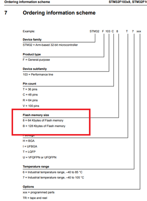

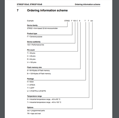

The answer is provided in the datasheet:
The only difference is the Flash size so you don't have to worry.
Thanks, so it's a yes on my request "1)", no issues replacing with STM32F103CBT6.
 As I said previously, no issue to migrate directly to 128kB!
