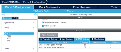

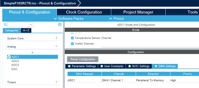

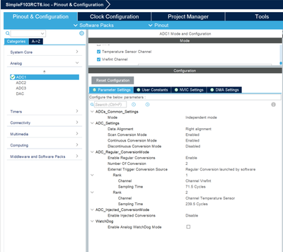

The ADC configuration:
The code:

static void MX_ADC1_Init(void)
  ADC_ChannelConfTypeDef sConfig = {0};
  /** Common config
  hadc1.Instance = ADC1;
  hadc1.Init.ScanConvMode = ADC_SCAN_ENABLE;
  hadc1.Init.ContinuousConvMode = ENABLE;
  hadc1.Init.DiscontinuousConvMode = DISABLE;
  hadc1.Init.ExternalTrigConv = ADC_SOFTWARE_START;
  hadc1.Init.DataAlign = ADC_DATAALIGN_RIGHT;
  hadc1.Init.NbrOfConversion = 2;
  if (HAL_ADC_Init(&hadc1) != HAL_OK)
    Error_Handler();
  /** Configure Regular Channel
  sConfig.Channel = ADC_CHANNEL_VREFINT;
  sConfig.Rank = ADC_REGULAR_RANK_1;
  sConfig.SamplingTime = ADC_SAMPLETIME_71CYCLES_5;
  if (HAL_ADC_ConfigChannel(&hadc1, &sConfig) != HAL_OK)
    Error_Handler();
  sConfig.Channel = ADC_CHANNEL_TEMPSENSOR;
  sConfig.Rank = ADC_REGULAR_RANK_2;
  sConfig.SamplingTime = ADC_SAMPLETIME_239CYCLES_5;
    Error_Handler();

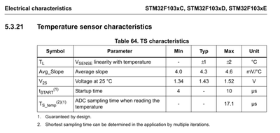

The temperature sensor characteristics:
You have continuous conversions on, so the ADC is constantly running. For what you are doing, this seems like the right thing to do. Just set it to convert those 2 channels forever, and put them in a circular buffer. Read them out whichever you want. Only call HAL_ADC_Start_DMA once at the start.
> The room temperature is around 21 degree centigrade while the reading is 31.
This is consistent. The reading you are getting is the junction temperature on the chip, which will be higher than ambient as the chip is using power and heating up. A delta of 10 C is normal. Slowing down your chip so it uses less power and heats up more will reduce the difference. If you want to measure ambient temp, you will need an external sensor that stays at ambient temperature.

Your on F103 - ds:
So 1184mV is in spec.
> But if we put the temperature value aside, the converted Vrefint is definitely wrong, it should be very close to 3300mV rather than 1184mV.
Why do you think that? What does the data sheet or reference manual say? It should generally be ~1.2 V which is what you're seeing.
